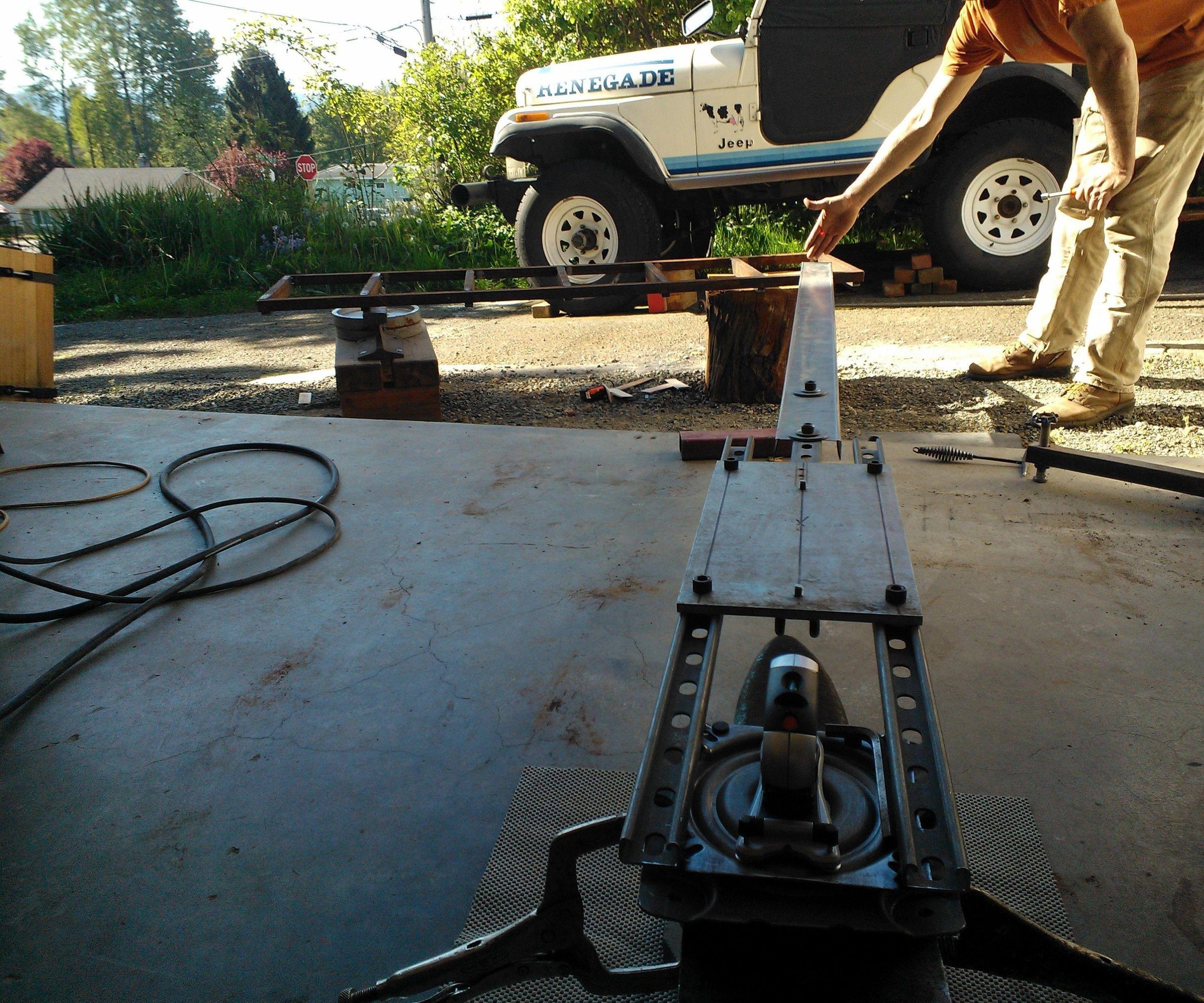

Step 2: Jig
So ,I made a jig to help

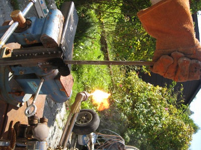

Step 4: Using Our Torch We Heated the Hex Steel at the Score Mark While Holding It Above the Jig
The jig has 2 tubes that are sealed at the bottom to bend the hooks at each length.
Step 5: Bend It
By using the torch I could heat a small area and by using the jig which was built to let the hex steel bottom out and then bend using light force.

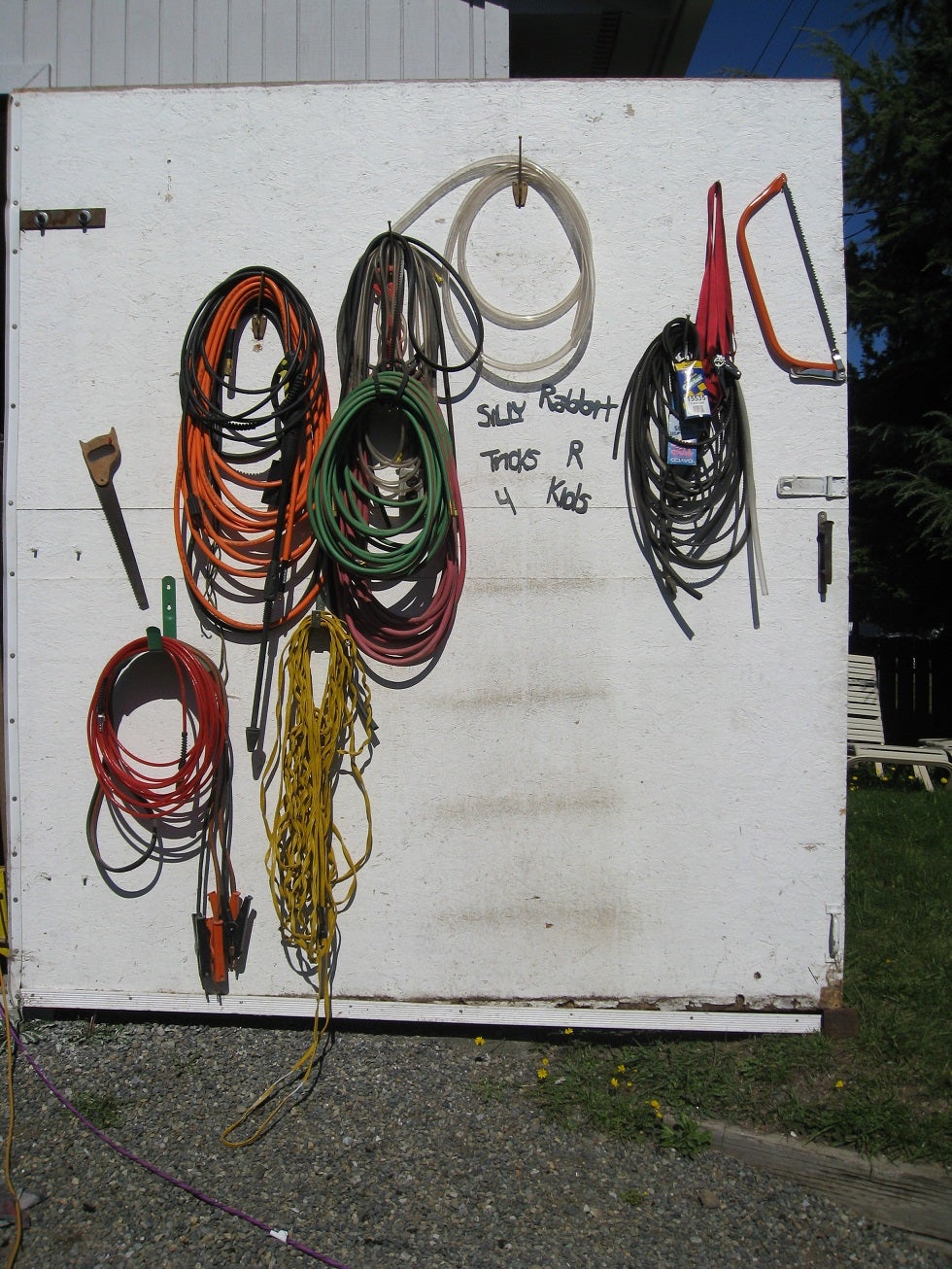

Step 7: Finished
I use the hooks for ladders, hoses and cords.
