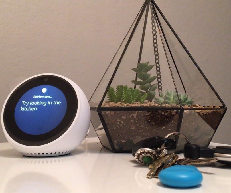

Introduction: Making of Kindbot: Customized Ambient Computing With Flask-Ask
Kindbot is powered with Flask-ask to control an arduino and raspberry pi. Flask-ask, a flavor of Flask, is a relatively new tool that allows you to set up your own local server to control anything with Amazon Alexa. Many projects showcase how to use Lambda as the brains for your Alexa skill. This entails setting up lambda functions and any other services needed to support the application (S3, dynamodb, etc.) This flask-ask tutorial probably offers the fastest way to test your home automation application using local compute resources.
