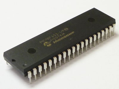

- PIC18F452 Micro-Controller

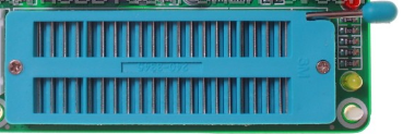

- PIC18FXXX DIP40 Locking Socket

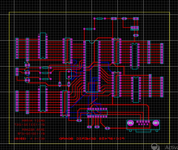

Step 3: Proteus Simulation PCB Designing (Software)
- We run a proteus simulation for our project first because it can further take us to PCB layout
First of all the given video can show you how to make a proteus project, schematic capture of the development board and PCB Layout.
- Now first select all the above mentioned devices
- Then place them to develop a schematic capture

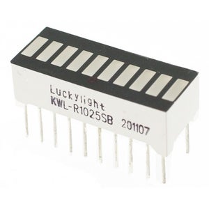

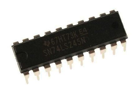

- The wiring is shown in the figure where all the four ports of PIC18F452 are connected with 74LS245 which is an octal bus transceivers that are designed for asynchronous two-way communication between data buses. Then these 74LS245 transceivers are connected with LED Bars which is a 10 segment bar graph they are 10 individual red LEDs housed together, each with an individual anode and cathode connection and these LED Bars are further connected with RES-PACK-8(8 way resistor pack with common) while CONN-SIL8 is connected in between them.

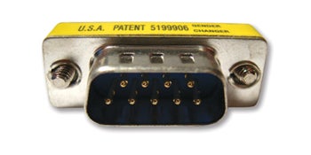

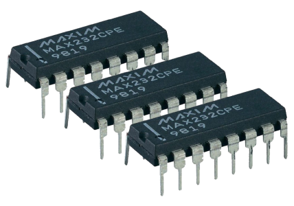

- CONN-D9M is connected with MAX232 which is used in Serial communication it basically provides communication through a serial port, this is a versatile IC which is one of those wonderful components that solve so many signal conversion problems. The T1IN pin max232(input of transmitter data) is connected with pin 5 PORT C of PIC18F452.

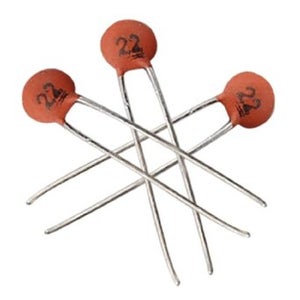

- A Quartz Crystal along with two capacitors of 22pF is connected with pin 13 OSC1/CLK1 and pin 14 OSC2/CLK0 of PIC18F452.

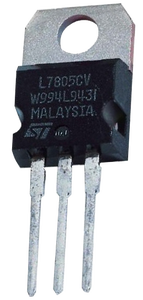

- A regulated power supply is very much essential for several electronic devices due to the semiconductor material employed in them have a fixed rate of current as well as voltage. So we use linear voltage regulator 7805 along with capacitors of 1nF. The input and output pins of the regulator are connected with CONN-SIL2

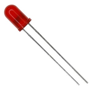

- We have one port on PIC18F452 with three input/outpur registers for them we use separate LEDs and connect them with three respective resistors of 220 and in between them there is CONN-SIL3 and the LEDs are grounded from the other side.
- After this run the proteus file in order to check wiring errors
After watching the video or following every step demonstrated in the video you can easily built your proteus simulation.

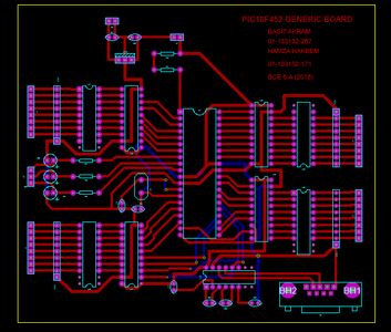

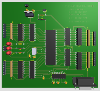

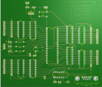

Step 4: PCB Designing (Hardware)
- Print out the Layout of your Development board on Glossy Paper.Make sure you have laser printer for printing a layout.
- For PCB board first we apply liquid soap on the board. Then we rub it with scotch-brite till it gets shiny. Then we soak it with water and clean it with the cloth.
- Now to transfer the design onto the board for this purpose we can put glossy paper upside down on Printed Circuit Board. now press the board by using iron on its maximum heat setting. press it for atleast 20 to 30 minutes. make sure your glossy paper cannot be slipped on it.
- After this step we wash the board till all the paper completely gets removed. Make sure don’t remove the lines. And darken the non transferred lines with permanent marker.
- now you can see that your layout is printed on it.For etching pour ferric chloride in the boiling water and put the board in it.
- When the copper from the board is removed then etching is done, wash the board.
- Use steel wool to remove the toner and then PCB is ready.
- Use drill machine to drill (0.8mm or 1mm Drill bit). After drilling attach all the components on the PCB using soldering.
- Make sure the connecting paths are not short and the paths are clear.
- Use Digital Multi-Meter to check the short and incomplete connections of copper.
- If any connection is NOT complete, make it complete by using Soldering wire and solder them.
Now your complete PCB is Ready to test... !!
