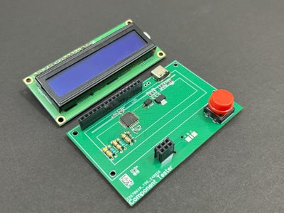

Step 4: PCB Designs:
I made this minimal design using the above given modified schematics. You can download all the files and code from here. Programming headers are added on the back layer to change/ update the firmware.
I am using FR4 material, HASL finish, Green solder mask and 1.6mm thickness. A very thanks to Seeed Fusion for sponsoring this project. Seeed fusion is one of the leading PCB manufacturing companies in China. Deals in PCB manufacturing, SMT assembly, PCBA, stencil, 3D- printing and CNC. Try out the more services from here now, and get free PCB coupons on first Sign-up using thie above link.

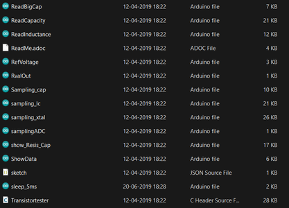

Step 5: Uploading the Code:
Full code can be downloaded from here, try to install the latest libraries for the LCD. You can comment here, if you find any problem in uploading the code. The code has more than 10 header files, so don’t get confused with that, just keep focus on Ardu-tester_1_13 and upload it using simple steps.

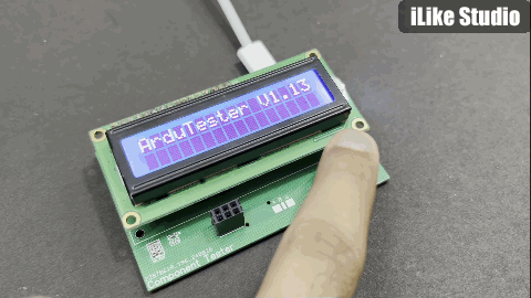

Step 6: Working:

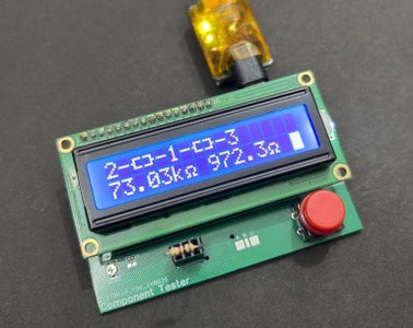

I encountered some problems while uploading the code in an ATMEGA328, after some research the problem is with the bootloader and type of chip. Atmega chip with mini_core bootloader will not work here because of absence of some internal registers. It doesn’t support the code layout at all and we can not use some functions. My idea is to use an Arduino NANO microcontroller for this and that’s what I did. PCb has its own programming pins, and the chip can be programmed through SPI(serial peripheral interface). This component tester can test all of the passive components and most of the active components. Like- Resistor, capacitor, inductor, BJT, UJT, MOSFET, IGBT, diode and LED. Here I have made some tests using my version.

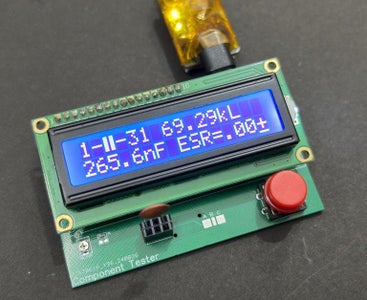

This version not only tells the value of the component but also gives a small usable datasheet of that component. For example in the case of a capacitor the capacitance value, ESR, series inductor and resistor values can be obtained. Hence we will be able to calculate parasitics through the actual model of a component.
Step 7: Testing Resistor:

Step 9: Testing Capacitor:
