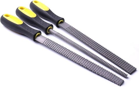

  2. Rasps - these will be the work horse tool. Get the most aggressive coarse set you can find. In all honesty, a cheap set from Harbor Freight was perfect. (This set specifically)
