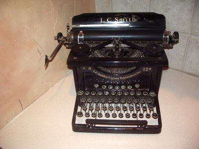

This LC Smith & Corona model 8 typewriter was built in 1930. I picked it up at a flea market and spent several weeks repairing and rebuilding it. One of the things that intrigued me about this old typewriter was that it came with "decimal tabulation" keys (see photo 3). These keys were designed to let the typist set tabs for a column of numbers, so they didn't have to use the space bar to align each number typed into the column. It was sort of a novel feature, but apparently never became very popular, because they discontinued this feature after only a few years.

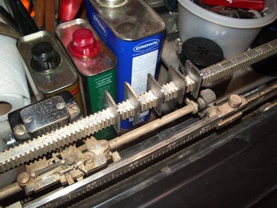

I knew I would need to make two tab stops (one for the decimal position, and one for all the others). I decided I would go ahead and make 5 instead of 2, since I could use the stops to set multiple tabs if I wished. I couldn't find a photo of what the tab stops looked like, but it wasn't too difficult to figure out where they should be installed and what they needed to look like to be functional.

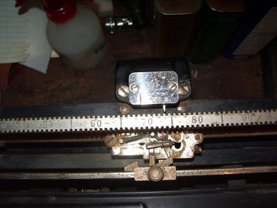

The square bar in photo 2 was made with teeth on it, and the tab stops were made to slip over the teeth. In photo 3 I have pressed one of the tabulation keys, and if you look closely you will see a small metal tooth has projected outward, and this tooth is designed to meet a tab stop and force the carriage to stop.
I found the groves between the teeth on the square bar to be 3/64ths of an inch wide. Luckily, I just happened to have some precision ground tool steel that was 3/64ths of an inch thick!

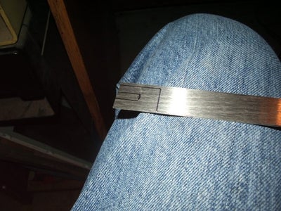

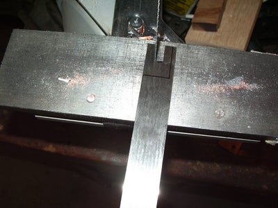

I measured the width needed for the tab stops to straddle the grooves, and the length and depth needed, and marked the dimensions on the steel bar (photo 1).
Using a metal cutting bandsaw, I cut the piece out, making sure to leave just a little bit of excess where the stop would fit onto the square bar (it's a lot easier to remove steel than to put it back!). I then hand-fitted the stop using a file to carefully widen the opening until it fit just right.
I then repeated this process four more times!

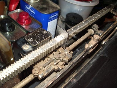

I now had five tab stops to tune. Tuning involved adjusting the width of each stop so that it would mesh correctly when the key was pressed. I roughed out the width with a stationary belt grinder, then find-tuned the width with a file.
That was all there was to it. The project only took about an hour, which was less time than I had spent looking online for replacements to buy!
