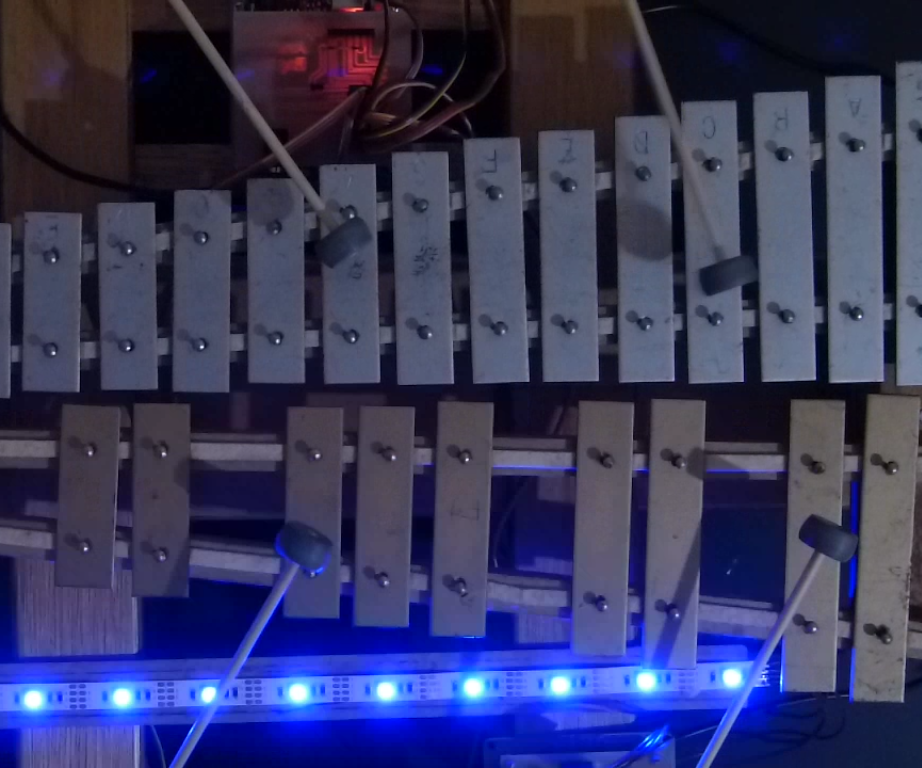

Step 1: Find a Glockenspiel and Make Support Frame
We had a 40 plus year old glockenspiel that was rescued from a high school music department when it became surplus to requirements. It has sat in a cupboard all this time waiting for an opportunity to be used. It is a little knocked around and some of the keys are dodgy and give dull sounding notes, however, for the fun of making the project is did not warrant purchasing a new one.
The frame was made from 10mm thick plywood and is sized to fit the glockenspiel and to accommodate four pairs of RC modelling servos. The distance from the glockenspiel to the servo was determined to provide an arc so that the hammer head would strike the desired number of keys without hitting the tacks holding the keys in place. This worked out to be approximately 220mm from the centre of rotation of the servo to the centre of the keys.
Servo pair one strikes keys G5 through to G6.
Servo pair two strikes keys G#5 through to G#6.
Servo pair three strikes keys A6 through to G7.
Servo pair four strikes keys Bb6 through to F#7.

Step 5: Make Hammers and Attach to Servos - Picture 1
The hammers are made from 3D printed heads and 4mm bamboo skewers (available from your local supermarket). The heads are attached with cyanoacrylate glue and the hammer assembly is attached to the servo bracket with two cable ties on each. These were not initially fully tightened to allow for adjusting the length when setting up and testing.

Step 10: Arduino Code
Add the MIDI.h library to your Arduino programming environment and compile and upload the attached code to the Arduino.
Note line 81:
Serial.begin(115200); //use computer baud rate not the true midi baud rate of 31250
As commented, we are sending the Midi data to the Spielatron over a USB interface at a normal computer baud rate not the correct Midi baud rate of 31250 as none of our computers could easily be configured to this baud rate.
Also you will note that the code only deals with note on Midi events as the hammer must be raised immediately after lowering and cannot wait for a note off event to occur.
