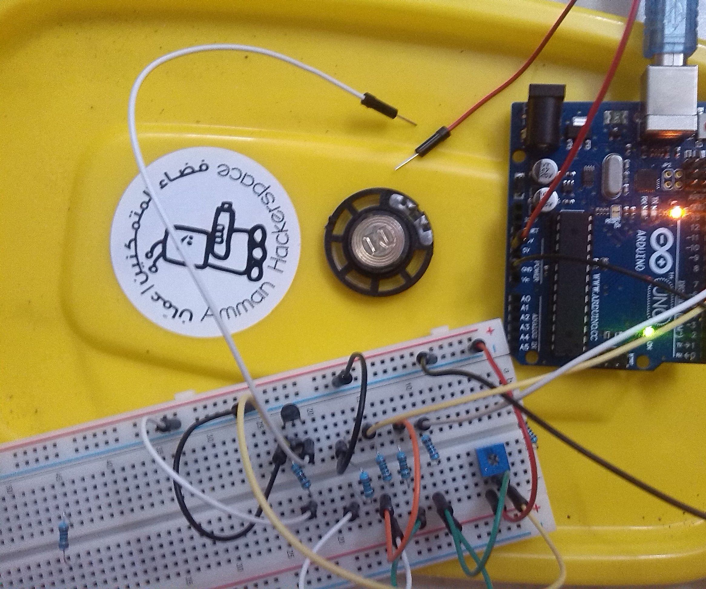

Introduction: Making the Simplest Bare Breadboard Arduino Without Crystal
UPDATE: step about UNO as USB/TTL and regulated voltage added.
We are going to build the most basic Arduino. We are going to drop the need of crystal by using the internal oscillator running at 8MHz and would build custom bootloader to handle this. We only need a breadboard, an AVR microcontroller (Atmega328p-pu) and a bunch of wires. You might add an LED on pin 13 (to test most basic sketches) and its resistor. Hardware reset would need a resistor (10K ohm would work) and an optional button (you can use a wire). For auto software reset you would need a small capacitor (100 nano Farad).
