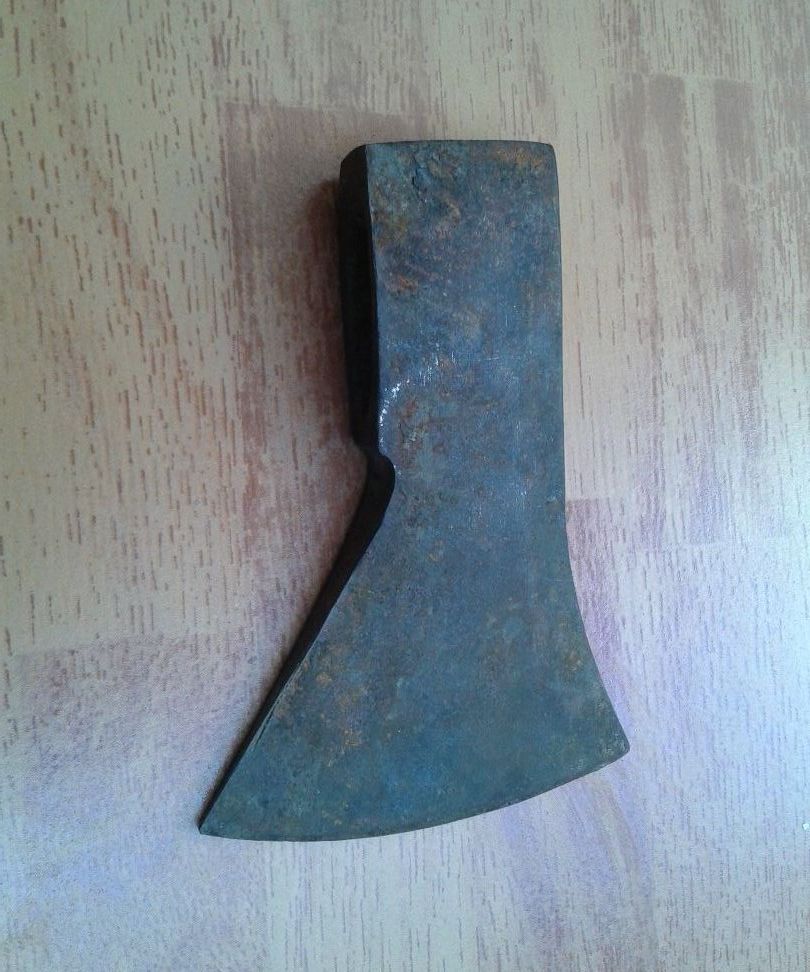

In our piece of land, we have this tree (Melia azedarach) that has a really tough grain and wood, the tree needed cutting every few years and logs from it set in the stockroom getting dried up. one of the logs had this curve that looks familiar to an axe handle, so i took it, split it in half, and clean it from the bark.
Note : to see how i restored the axe head shown, watch my other instructable :
https://www.instructables.com/id/How-to-remove-rust...
the steps here are symmetric to the pictures by order :
  • I begin carving the shape i want with a razor and a wide U chisel
  • Draw the handle outline on a paper, on top of it draw the axe head u bought to see how it should look and how much space it will take to fit in the handle, then draw the design, i don't know why i chose a horse, maybe that's an axe warrior's biggest threat ,since a well armored knight would have an advantage over him with a long sword or spear anyway, draw whatever you like.
  • Mark the handle to where the axe should fit, the "eye" is the axe part that fits in the handle
  • Start removing wood gradually to take the shape of the eye, sand it to make a smooth round, you'l notice this dark rust on the handle since i consistently pull it in the head to know where to remove wood
