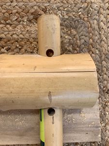

On the small diameter bamboo sticks we are going to do drill holes of
10mm (0,4″) separated by the size of our big diameter bamboo. As one image is worth a thousand words, you will understand it better from this picture :
Step 9:
So at this moment, you should have 2 sets looking like this:
