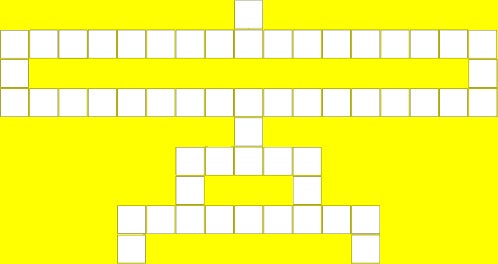

Two boards were cut with a jigsaw each to 350mm long and 182mm wide. I then printed off the design i wanted to use to help mark my holes. I found the centers of each square by X-ing them on the paper, taped each paper half to the two wood boards and used a center punch and a rubber mallet to make a mark on the board to let me know where i need to drill the holes.
