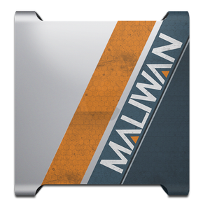

The original paint job was a chipped black gloss with some sort of red primer or prior coat showing underneath. Despite trying to remove these with solvents, heat and physical methods to expose the original silver aluminium, I had to resort to painting over the existing layers. Since I was completely covering the old paintwork, I decided to add some flair and theme it based on the fictional Maliwan weapons company (Borderlands).
I was heavily inspired to take on this project after seeing venounan's Maliwan themed Bitfenix case
The logo and stripe positioning were largely based on malfunktionv2's Borderlands wallpapers
I designed a hexagon pattern to break up the stripes slightly, and used both the offcuts and the lines for form the patterns.
Rather than stencil the letters in, I knew I'd achieve a much cleaner look by physically sticking them to the case

Step 5: Painting the Case
While I don't recommend pound land for paint durability, they had a chrome wheel spray paint that almost perfectly matched the original aluminium, so I used that as the base coat.
I masked off the DVD tray, the stripes down the sides, then added my hexagon cut-outs by applying PVA to the paper and pressing it down to spread the glue to the edges, then masked off each section in turn.
While I had gloss navy blue left over from my Mjolnir Armour, the other two colours had to be custom mixed from acrylic. I used a ratio of about 5% PVA, 20% acrylic and 75% water to give the paint some resistance to chipping and allow it to be airbrushed on (My airbrush struggled with this mix, so I watered it down slightly more after the first coat).
While it may have also been the acrylic, the PVA seemed to make the paint almost "stretchy" when I was removing the stencils, so the orange hex pattern looked a lot less tidy. I'd advise trying to complete it with spray paint cans instead.
The final stage was to add the letters, which I stuck directly on rather than stencilling. They were initially almost perfect, but I had to cut them out again where the paint bled and stuck them to the newspaper, so use something like a blue-tack standoff when painting them (I did this for the orange triangles in the "A"s, which worked perfectly).
Step 6: Final Assembly
Here is the (pretty much) completed case, with only a few enhancements like clearcoating it and fitting the front panel more securely.
