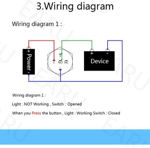

Step 11: Diagrams and Source Code
Here you can find the wiring diagrams for arduino, power switch, potentiometers, transistor and source code for the arduino board.

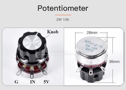

Step 12: Potentiometers
I'm using two potentiometers, first one (purple wire) will control the brightness from 0 to 100%, second one (green wire) how long the light will be on, in my case from 1 to 15 minutes. I did not have faston connectors so I had to solder them.
Open holes for the power switch and potentiometers on one of the sides.
