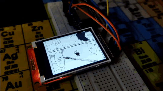

Step 1: Concept/BREADBOARD SETUP

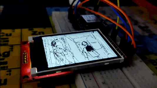

It all began with a straightforward Nodemcu and ILI9225 display setup that was being used to sequentially display a few images when the thought struck: what if we could display a series of comic panels—specifically, manga panels?
In order to test this, a few manga panels were downloaded and cropped to 176x220 pixels because the ILI9225 we're using comes in that size.
After resizing images, we run them through "Image to C Converter,"
It basically turns images into C code, which we include in the main code, which runs each image one by one in a loop.
We connect NODEMCU with the ILI9225 Display with the below pinout-
  • VCC of display with Vin of NODEMCU
  • GND to GND
  • CLK to D5
  • SDA to D7
  • RS to D2
  • RST to D4
  • CS to D8
Next, we need to install this library in order to run the sketch.
Once everything is set up, we can upload the sketch to the NODEMCU Board to create a digital manga slide show!
Level 1 was this. In level 2, the ILI9225 display will be driven by a basic ESP12F setup, and battery functionality will be added to make the system portable and useful.

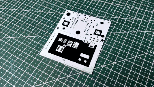

Step 3: PCB Design

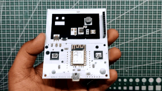

This project's PCB design includes an ESP12F Minimal Setup connected to an ILI9225 Display.
The ESP12F's minimal setup consists of a few resistors pulling down GPIO15 to GND, pulling up the reset pin, EN pin, and GPIO0 to 3V.
An IP5303 IC setup, a power management IC that converts 3.7V of a lithium ion battery to 5V for charging a smartphone or powering any 5V device, is used to power the ESP setup.
The ESP8266 is a 3.3V device, so providing it with 5V will instantly fry the chip. To solve this problem, we added an AMS1117 3.3V Voltage Regulator setup that steps down 5V from the IP5303 to 3.3V to allow the ESP to function as intended.
Following the completion of the schematic, the board was created using the PCB Model DWG file and then sent to PCBWAY for manufacturing.
Step 4: PCBWAY Service
After the PCB Design was completed, Gerber data was generated and then sent to PCBWAY for samples.
An order was placed for the PCBs with white soldermask and black silkscreen, as its looks pretty cool in general.
The PCBs were received within a week, and they were excellent, as expected.

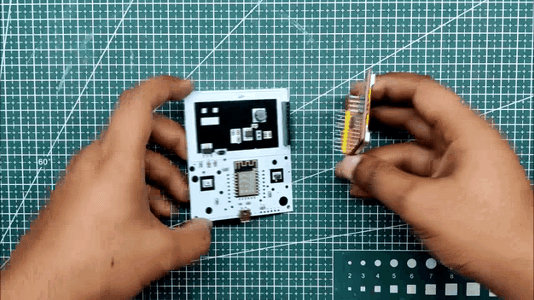

Step 5: PCB Assembly
  • Board Assembly Process begins by first adding solder paste to each component pad one by one.
  • Next, using a tweezer, we pick and position each SMD component in its designated location.
  • Following that, we carefully lifted the entire circuit board and set it down on the Mini SMT Hotplate, which heats the PCB from below up to the solder paste melting temperature. As soon as the PCB reaches that temperature, the solder paste melts, and all the components are connected to their pads.
  • Next, we add the CON11 header pin to its pad and solder it using a regular soldering iron.
  • The board assembly process is then finished by soldering the USB Micro port's pads to the PCB.

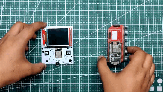

Step 6: ILI9225 Display
We are using the 2.0 Inch TFT Display which is powered by the ILI9225 Driver.
The ILI9225 is a driver IC (integrated circuit) used for controlling small to medium-sized TFT LCD (thin-film transistor liquid crystal display) panels. It supports displays with resolutions up to 176x220 pixels and 18-bit (262,144 colors) color depth.
In summary, the ILI9225 is a versatile and widely used driver IC for small to medium-sized TFT LCD displays, and it offers a range of display modes and features for controlling the display.
This display's very low refresh rate makes it unsuitable for running any project involving animation; instead, use the ILI9341 Display or a similar LCD if you want to run gifs or videos without stuttering.

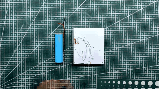

Step 7: Edit Done in PCB
We made some PCB changes prior to flashing, including rewiring the LCD's pins with an ESP12F module.
We disconnected the traces below and added silver copper wire to connect the LCD pins to the ESP8266's I/O pins because some connections were made during the preparation of the schematic in a way that prevented the LCD from functioning.
  • We cut the trace that connected CS to GND and connected it to GPIO15.
  • We cut the trace from RST's connection to GPIO15 and connected it to GPIO2.
  • RS was connected to SDA; we cut that connection, and then connected RS to GPIO4.
  • We cut the traces connecting SDA to GPIO4 and added it to GPIO13.
  • We cut the trace from CLK's connection to GPIO5 and added it to GPIO14.
The wiring is now correct after the aforementioned modifications, so we can test this board and flash the ESP12F with main code.

Step 9: Power Source
We are using a 3.7V 2500mAh Lithium Ion cell as the power source, and we are connecting its positive and negative terminals to the IP5303 setup's battery con2 from the bottom side.
When we press the IP5303 IC's button, the entire setup comes on, and the manga reader starts to function and display a panel of manga.
The project is now finished; all that is left to do is incorporate the circuit into the 3D Enclosure.

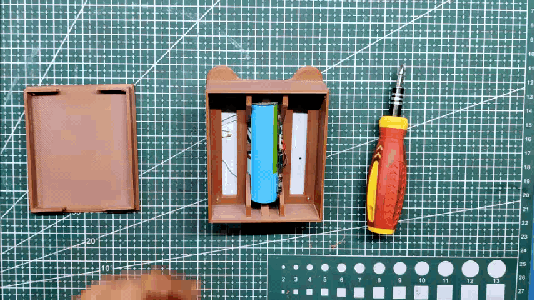

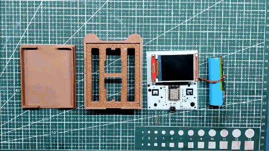

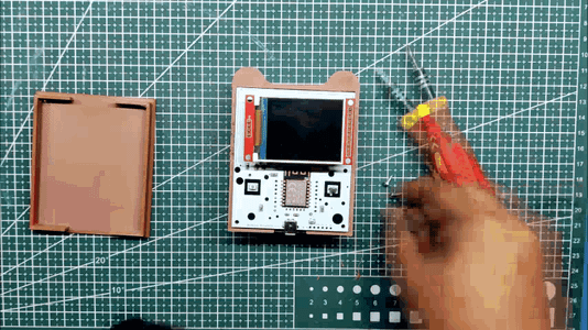

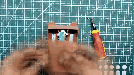

Step 10: Final Assembly
  • The battery is first inserted into the enclosure from the top side before the PCB is added.
  • Next, we insert two M2 screws to hold the PCB in place.
  • The device is then turned, and hot glue is added to the lithium cell to hold it in place.
  • Finally, a lid is added to the back of the enclosure and fastened with four M2 screws to complete the assembly process.

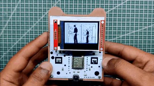

Step 11: RESULT
The Result of this built is a pocket manga reader that continuously loops through panels of manga; yes, the image quality is not the best and it required a tedious process of converting each image into C Code and then combining that code to make a single long code that is flashed into ESP8266 board.
The best thing about this device is its extreme overkillness and how we were able to create a display device that could be used for many XYZ things in addition to just displaying comics. This device is essentially a portable display with a WiFi module that can be used to do all sorts of things, from gathering weather information from the internet to getting the time, it has numerous uses.
Version 2 of this project will have a larger ILI9341 display and a slim form factor because the previous version's use of a li-ion cell, which has an 18mm diameter, made the device's body thicker. By switching to a lipo cell, however, we were able to make the device slightly slimmer.
