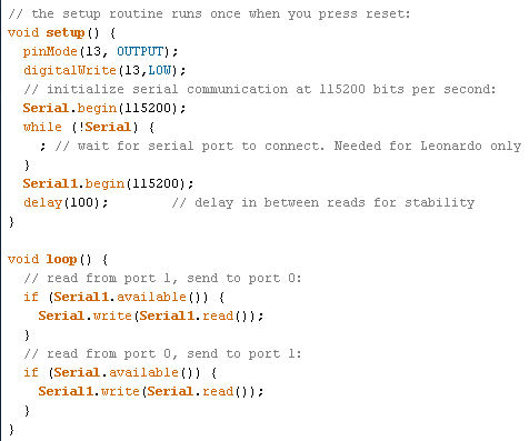

Copy following code (also shown in the pic) and upload the sketch
void setup() { pinMode(13, OUTPUT);
digitalWrite(13,LOW);
// initialize serial communication at 115200 bits per second:
Serial.begin(115200);
while (!Serial) { ;
// wait for serial port to connect. Needed for Leonardo only
Serial1.begin(115200);
delay(100);
// delay in between reads for stability
} void loop() {
// read from port 1, send to port 0
if (Serial1.available()) { Serial.write(Serial1.read()); }
// read from port 0, send to port 1
if (Serial.available()) { Serial1.write(Serial.read()); } }
