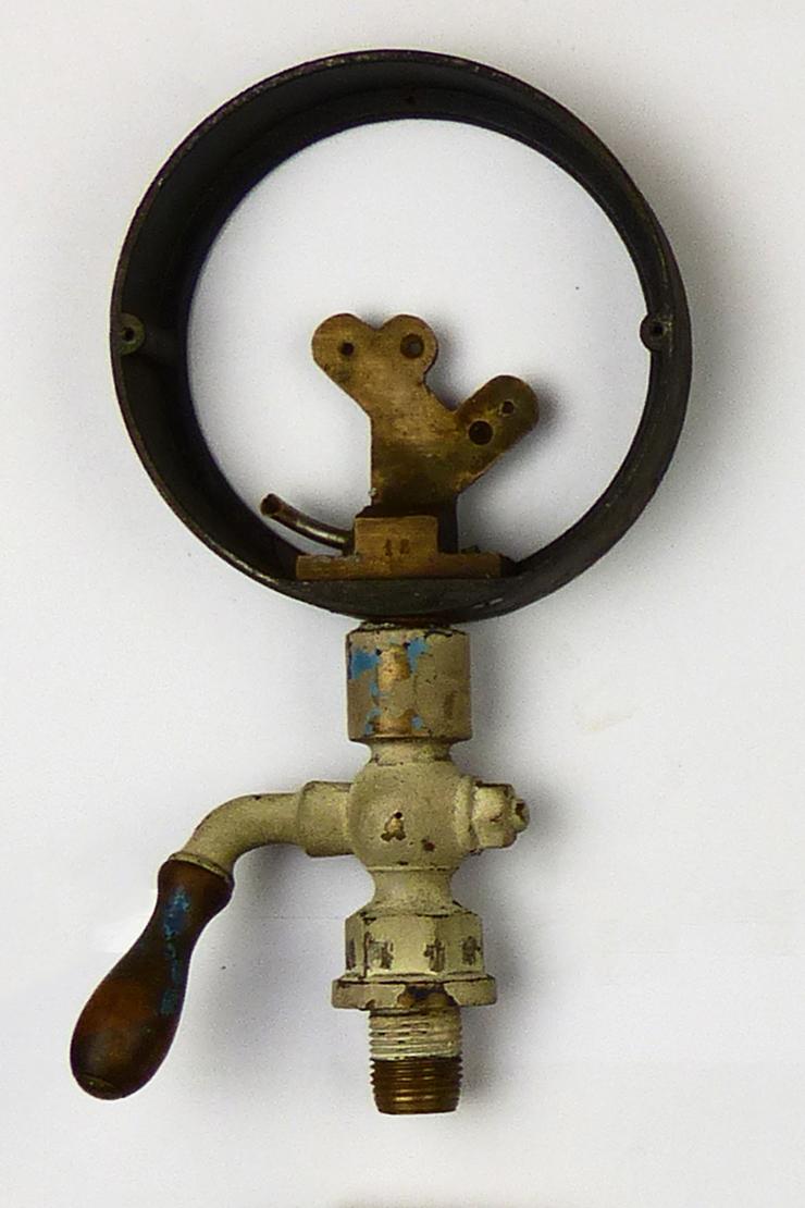

Step 1: The Before
With such old technology, everything still works fully mechanically: The manometer is screwed onto a pipe, and a hole runs from the bottom to the middle, where it transitions into the circular metal ring. This part is also hollow inside and expands when the pressure increases. Attached to it is a lever, with a gear (in the shape of a quarter circle) at the other end. As the lever is pulled to the side by the circular metal part, the gear rotates a smaller gear, which is directly connected to the pointer and moves it.
There is also a small balance wheel, but I couldn't figure out its purpose.
On the outside, there are many layers of paint (white over light blue over dark blue), which tell their own story.

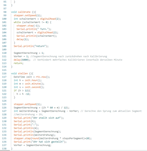

Step 5: Basic Programming of Each Component

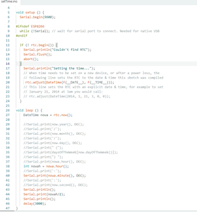

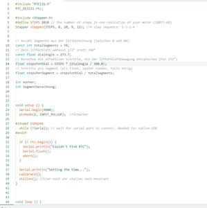

I tested each component beforehand with the basic sketches I think were integraded in arduino IDE. (stepper
I had problems with the stepper motor—it wasn’t rotating correctly counterclockwise. The solution was to change the order of the numbers in this line: Stepper myStepper(stepsPerRevolution, 8, 9, 10, 11); Instead of "8, 9, 10, 11", I switched it to "8, 10, 9, 11".

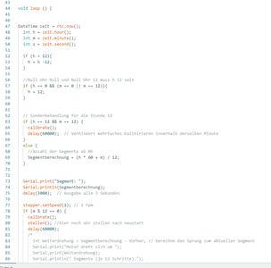

For the RTC sketch, there is a line in the setup: rtc.adjust(DateTime(F(__DATE__), F(__TIME__))); This line must be removed in the final program; otherwise, the clock resets to the time recorded during the upload to the Arduino every time the system restarts, instead of keeping the actual time.
The zero-position detector (in the final code called; void calibrate) works as follows: The stepper motor rotates counterclockwise while continuously checking whether a circuit is closed at Pin 2 (where the cable from the metal pin is connected). If the circuit is not closed, the motor continues to rotate. If the circuit is closed, the motor stops, and the program briefly pauses.
After that (void stellen), the RTC is read, and the current time is first converted into a 12-hour format. Then, the current time is converted into segments (each hour on the dial is divided into five segments). This is then translated into the number of steps the motor must rotate clockwise.
Step 6: Combining the Code
In this final program, all elements are combined.
However, there was one problem: My angle calculations did not match the correct segments/ the actual time. I couldn't find the calculation error, so I adjusted the numbers by modifying the total angular range of my clock face. Now, it works quite well.
What exactly does the program do? The pointer does not move continuously. The time is converted into a number of segments, and every 12 minutes (the duration of one segment), the pointer returns to zero and then sets itself to the new time.
Something happens every 12 minutes because each hour on the clock face is divided into five parts.
There is a special case at 12 o’clock: The pointer remains in position for 12 minutes, just like at any other time, and then at 12:12, it returns to zero.
