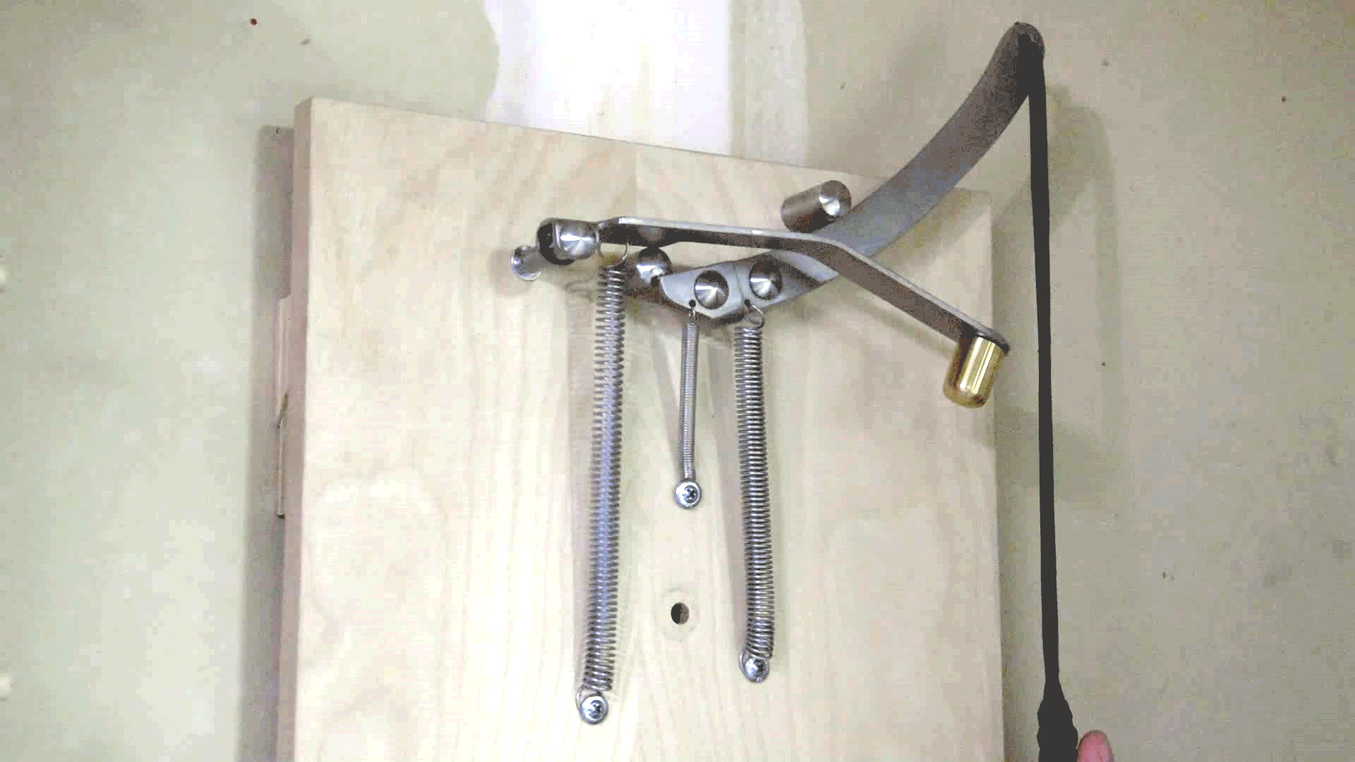

Step 4: Shape Striker
Cut the outside of the tabs and bend them using a vise. Bend the end of the striker slightly. This angle can be changed later.

Step 10: Attach Catch
The bolt for the catch needs to retain some of the square carriage bolt profile. Remove a small amount of it until it only has the thickness of the catch. Finish the head of the bolt as shown in the previous step.
Using small files, cut the hole in the catch square. Attach the catch to the lever arm with a lock nut. This will allow the tension on the catch to remain constant. Cut off the excess bolt.

Step 13: Drill Spring Holes
Drill two spring holes in the top of the striker bar. One spring hole in the edge of the catch and next to the catch in the lever arm.

Step 15: Assemble
Assemble the bell by fist attaching the stoppers (longer stopper on top). The lever arm assembly and springs are next followed by the striker arm. Finally attach the bell with a 5/16 in. carriage bolt.
