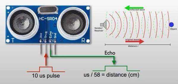

The HC-SR04 ultrasonic sensor was connected to the Arduino:
  • VCC of HC-SR04 to 5V of breadboard
  • GND of HC-SR04 to GND of breadboard
  • Trig to digital pin 3 of the Arduino
  • Echo to digital pin 4 of the Arduino

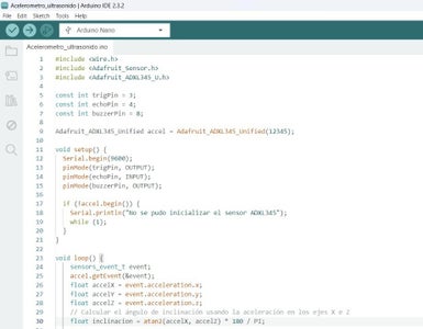

Step 3: Programming
The circuit was programmed so that the ultrasonic sensor detects objects from 50 cm away and turns on an auditory alarm, exclusively when the wheelchair user advances in reverse. This function was done using the accelerometer, which was instructed to measure acceleration on the negative Y axis.
In addition, a function was added so that when it detects positive Y-axis acceleration, i.e., when the person is moving forward, the sensor does not detect objects or turn on the alarm.
Another function was added to ensure that the detection of objects is effective in the position in which the circuit was placed in the chair, which is flat on a horizontal axis, eliminating inclination factors.
This step includes the file containing the Obstacle detection system code.
