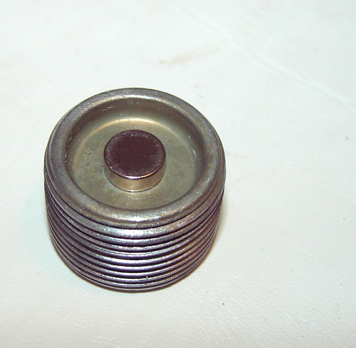

Step 4: Clean the Magnet and Remove the Filler Bolt.
The drain bolt usually has a magnet on it that catches the metal shavings. Clean them off really well. you can see how filthy it was on this vehicle. I'm betting it's been over 50,000 Kms for this vehicle.
