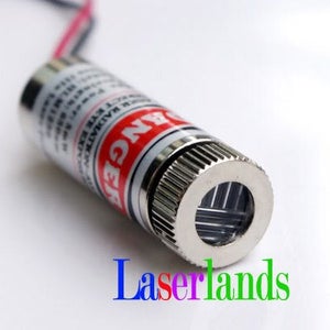

650nm <5mW Laser Cross Module Diode $4.37 ebay
The laser diode is a HLM1230.

Any laser you buy will have a DANGER sticker similar to this one. The particular laser that is I am using is 5mW. The typical laser pointer is 1mW. Now I’m haven’t researched laser safety that much but as I understand it, even a 1mW can damage the eye if looked at directly. This one is five times more wattage so use carefully. Do not aim it at a person or animal.
***********************WARNING**********************************
Some readers may wonder how the cross is generated. Search Ebay.com for this: 650nm <5mW Laser Cross Module Diode Some of the pictures (See picture) show that this module actually projects a red cross. This is created by a special lens used in this module. You can adjust the orientation by rotating the lens mount.
By the way you can get lens that also generate lines or multiple lines and some other patterns.
