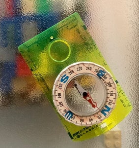

Step 1: Secure or Make a Compass

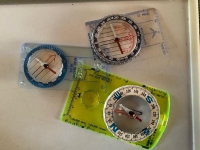

Secure a compass (photo 1)
Note: If you don't have access to a compass or compass app on your phone then you can always make a compass. Conduct a search using "make compass" at Instructables for a variety of simple ideas for making a compass out of everyday items.

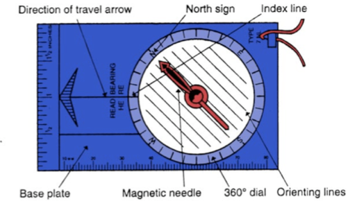

Review the names of the different parts of the compass (photo 2).

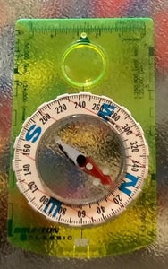

Step 2: Orientate and Read a Compass

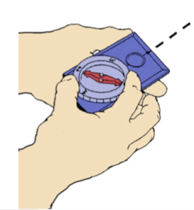

Orientate the Compass
Hold the compass steady in your non-dominant hand with the base plate level.
Hold your non-dominant hand in front of your body near your stomach.
Read the Compass
Position the "N" with the travel arrow.
Turn your body until the magnetic needle lines up with the travel arrow (you are facing north).

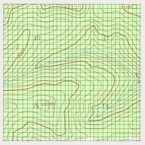

Mark it to Scale
Draw a 32x32 grid (see photo 1) over the map. The actual scale for these USGS Topographic Maps are marked on them. This scale says 1" equals 63,360" or 5280 feet or 1760 yards.
Note 1: I printed my map at 6" x 6" and my horizontal and vertical lines were at 1/16" (.1875") intervals to match 32x32 grid.
Note the Altitude
Label each cell on the topographic map with the altitude (I abbreviate 3000 as 30, 2100 as 21), so that the numbers would fit in the cells (see photo 2).

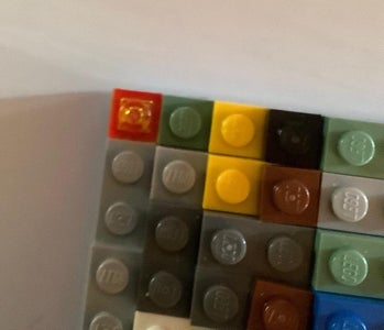

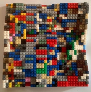

Step 4: Create a 3D Topographic Map
The 3D Topographic Map (photos 1-7) is made out of legos. Start with a 32x32 baseplate. Note the lowest point on the topographic map (mine is 1900') and the highest point (3300'). 1900' is at the baseplate and every 100 feet in elevation adds 1 plate. The high point is 14 plates high. Remember one brick is 3 plates, so bricks also may be used. I used the trans plate (see photo 8) to mark the north west corner of the topographic map.
The representation of the 3D Topographic Map, for our purposes, is 3200 feet by 3200 feet so that the distance between any two horizontal/vertical lego studs is 100 feet.

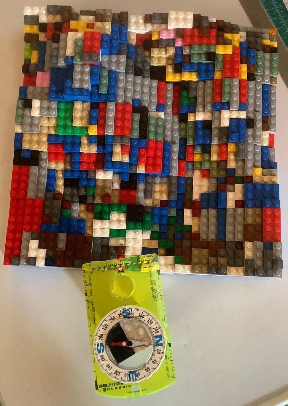

Step 6: Take a Bearing
Position the 3D topographic map so that its northwest corner is at the northwest point using the compass (photo 1).
Find the lowest and highest elevation on the paper map.
Locate the lowest and highest elevation on the 3D topographic map.
Take a bearing on the highest point from the lowest point.
  1. Stand so that the compass is over the lowest point.
  2. Position the compass facing the highest point (see photo 2).
  3. Match the magnetic arrow with the baseplate arrow (see photo 3).
  4. Read the bearing at the travel arrow.

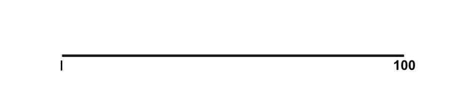

Step 7: Determine Pacing
Mark off 100 feet.
Start at one end and walk naturally to the other end.
Be sure to walk in a straight line.
Repeat three times
Count the number of paces each time.
Average the number of steps to determine your pace.
