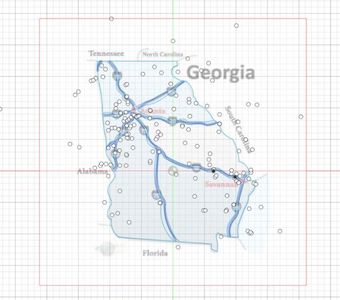

Step 2: Pick Design and Import
Import a picture of a Georgia highway map, as seen (or whatever map you want), into fusion 360 using the canvas feature.
Step 3: Trace
Trace the outline of the state and highways. Or if you picked a closer view trace the streets or what ever you wnt to map.

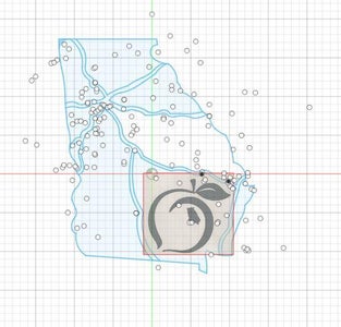

Step 4: Extra Personal
If you want to add something else you your design you can import the picture into fusion using canvas and place the symbol or what you chose in the placement you want. I put a peach inside the state outline. Then trace the symbol.

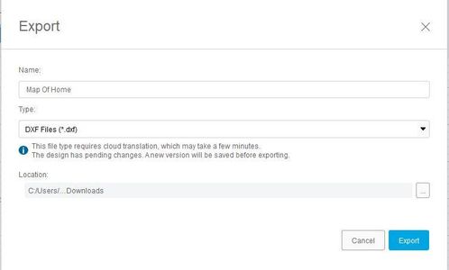

Step 5: Save and Export
Save your drawing on fusion as a DXF file. This is so that you can send it to a laser cutter, in my case a Boss Laser. After sent to the laser cut place you would in the correct placement so the design is in your desired placement on the wood.

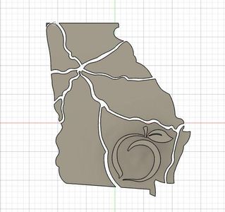

Step 6: Decorate
After your piece has been laser engraved you can stop and leave the wood plain or decorate it usng stain, paint or anyth
