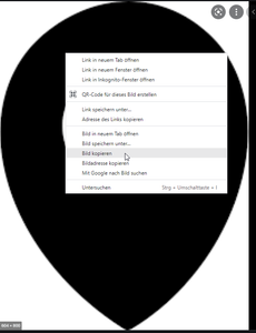

I searched fitting Icons for the remarkable moments in Google and used Inkscape to create paths out of the free available icons.
Example:
I first took notice of her during a sports event (football match) many years ago, and later we met again on an event where she sold Tarte flambée. After that we dated and so on...
That is why I took a football and an fitting image of a Tarte flambée. I guess you get the point.

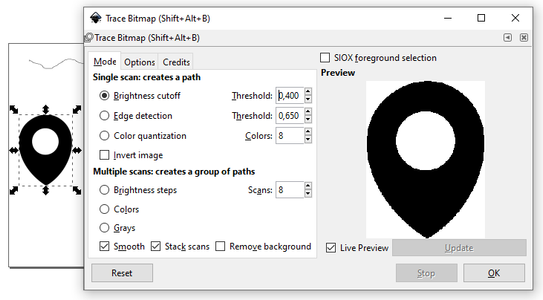

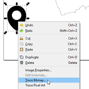

Copy the Image to Inkscape, and select the "trace bitmap" functionality.
Then choose the best options, in my case "brightness cutoff" worked the best since most icons are black and white.
I continued until I had all the icons converted to vector graphics.

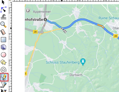

I just set up the route in Google maps and took a Screenshot.
I copied the resulting image to Inkscape and just redraw the route by hand using "draw freehand line" function.
The resulting line then can be used without further adjustment.
If you want to do something similar and the streets in your country are more straight, you can use "draw bezier curves" also.
