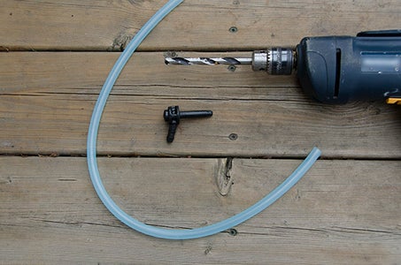

You need:
- taps, one per hole;

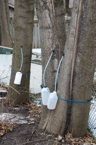

- containers to collect sap (we used clean plastic bottles from orange juice);
- tubes to direct the sap into containers, fit to taps;
- a drill, a bit should be the same diameter as the taps.

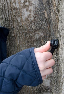

Step 2: Tapping Trees
Drill a hole and insert a tap. The tap should be fit tightly with some effort.

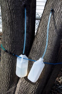

Step 3: Set Up the Containers
To protect our sap from animals and dirt, we used containers with lids. Every lid was drilled to accommodate a tube. Clean and safe.

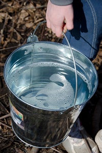

Step 4: Collect the Sap
When the containers are full, you can empty them and close the holes with stoppers made from wood chips or twigs if you wish.

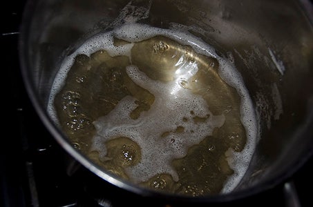

Step 5: Evaporating

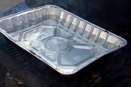

To produce one part of syrup you would evaporate forty parts of sap. Just imagine how much vapor there would be. The best way to do that is an open fire outdoors. When the sap is getting thick and intense in colour, you may complete the process in your kitchen, because it will require all your attention - you must stop right before the syrup turns into caramel.
