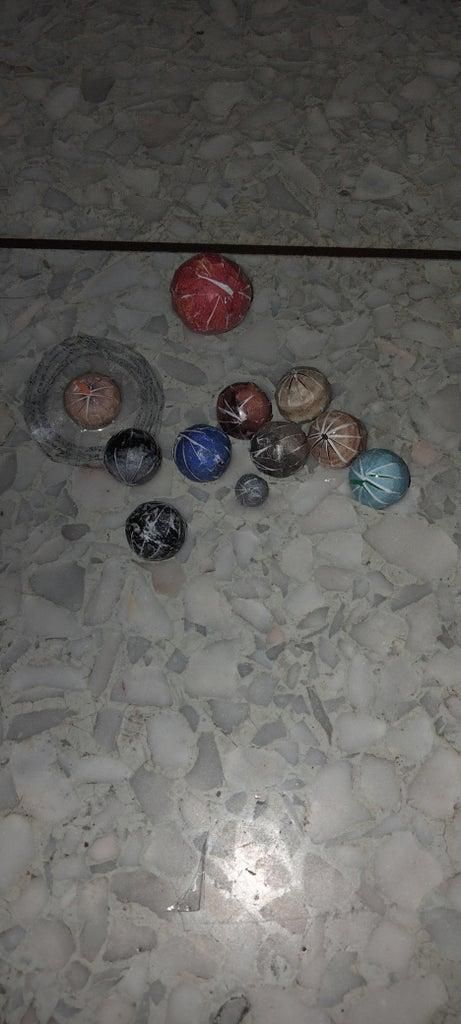

Isn't our solar system beautiful? I decided I needed some mini planets. You can print the attached PDF and use with regular marbles, one mini marble, and one masher. (Marbles are not standardized, so it may not be a perfect fit.) Or, you can download the folder with the InDesign file and scale the images to the correct size for your spheres.

Step 3: Glue It On
Apply a thin line of glue to the blank side of the gore. Wrap it around the marble and press. Spread glue on each of the open ends of the marble and press the tips of the gore down. Be careful not to smudge the ink with excess glue or glue on your fingers.

Step 5: Make a Display
Using aluminum foil, make little ring stands for your planets. You can check out my aluminum ring instructable here: https://www.instructables.com/id/Hammered-Aluminum-Foil-Rings/
