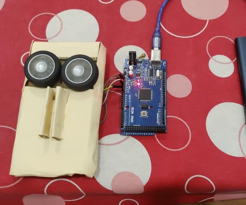

Step 3: Making the Conveyor's Base
Make the base with two rectangles of 12.5cm x 35cm. Make a hole at the lower end to accomodate your motor, ensure that the diameter and width of the drive and tail wheel is same. My conveyors had a width of 3.5cm.
Attach a long cardboard piece for extra strength and this ensures the belt and marble don't slip.

Step 7: Electronics
I used an arduino mega and 2 stepper motors however these can be changed according to lenth and load.
