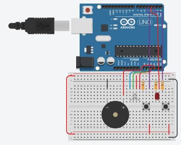

Step 1: Button and OUTPUTS!
Connect the buttons and the outputs! LED, RGB, and piezo buzzer are the output components to put in first. Also plugin the buttons with the 330 ohm resistors.
Pins:
2 = Button
3 = LED
4 = Button
A0 = Blue pin
A1 = Green pin
A2 = Red pin
A3 = Piezo buzzer

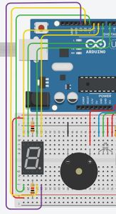

Step 2: 7 Segment Display
Connect the 7 segment display to the Arduino! Pins are hard to explain so try to follow the the wires.

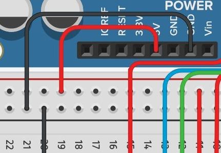

Step 3: 5V and Ground
Connect the 5V and GND on the Arduino to the breadboard.

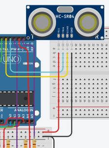

Step 4: Ultrasonic Sensor
Connect the ultrasonic sensor to the Arduino! Trig to pin 5, Echo to pin 6.
Step 5: FInished!
Finished, now you can run the code and see it work!
