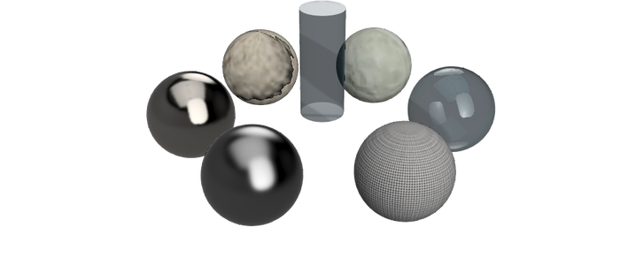

Cement
Rebar
Titanium
Steel Alloy HY-100
Glass
Acrylic

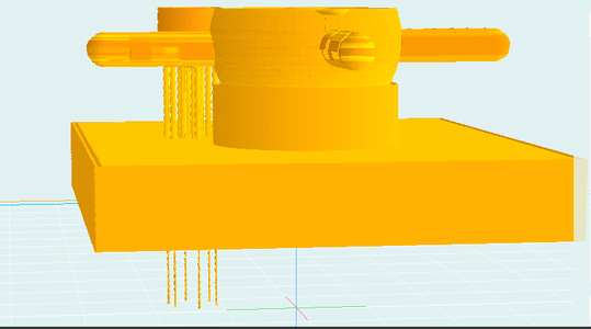

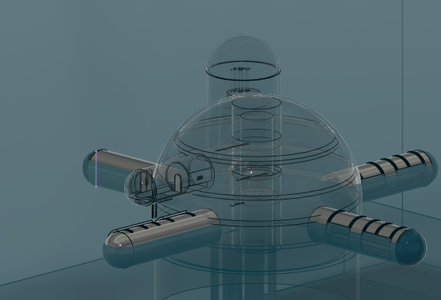

Step 4: Proposal
In order to meet the guidelines listed above, it was decided to develop a modular, saltwater habitat based off of a NASA Mars habitat design, using the specifications above and some of the additional requirements listed in the 2018 paper Advantages of a Modular Mars Surface Habitat Approach. While some of the conditions listed in the paper do not apply to this project, it does provide an important resource for any extreme environment design. Namely, by utilizing a modular design, the amount of time and money is decreased per each capsule, and the room for error is slightly greater than for a larger “monolithic” design, where a single, minor error could mean that the entire large environment is jeopardized or be scrapped. In addition, because of the long-term nature of the habitat in an environment that is a harsh, unforgiving terrain with constant chemical attacks from salt on materials, fatigue and endurance limits always a possibility of being tested, and the possibility of rescue or repair would most likely take longer than threatened occupants would have.

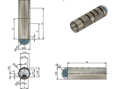

As such, this design calls for at least 8 modules with a pressure hull thickness of .27 meters (appr. 10.6 in) to be the minimum number for a fully-operational base with additional modules being able to be added to provide greater research capacity, additional recreational facilities, or observational sites. The modules initially necessary would include:
  • A energy production module housing a nuclear reactor similar to that aboard nuclear submarines
  • A main “hub” module for the fraternization and socialization of the crew, in addition to the central controls for all modules, including life support, gas monitoring, radiation observation, and communication

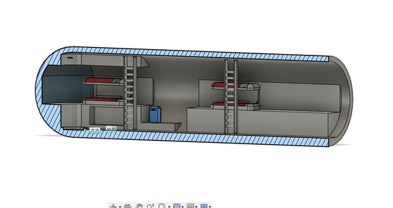

  • A living/washing facilities module for the crew members as well as the secondary controls for the habitat
  • A moon pool and saturation diving conditioning module for manned diving
  • A “hanger” module for the launch of manned and unmanned submersibles and research devices
  • A fabrication room for the usage of repairs and development of devices
  • A greenroom module for the growth of the sustainable plant life
  • A storage module for the inevitable amount of supplies that must be preserved.
Although the habitat could be operational without at least three of the modules, the number allows for a great deal of variety of modular placement options and a range of operations. The location proposed for such a habitat is either on the edge of the Australian Continental Shelf, close to Hawaii, off the coast of Texas in the Gulf of Mexico, or off the coast of Guadeloupe, with special preference given to the Gulf of Mexico location. This location is recommended due to the plethora of existing facilities that have experience in building large marine structures, specifically offshore oil rigs. By developing the habitats modules in this area and having geological and civil engineers who are comfortable in that region, research and development costs for preparing the seabed for the arrival of the habitat could be minimized.

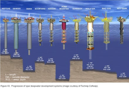

  • The materials to build such a habitat could be high-strength Portland cement, HY-100 steel alloy, titanium, acrylic, glass. The reason for using Portland cement is that it is one of the most common cement mixes in usages such as foundations for offshore oil spars, bridges, and other structures that are constantly attacked by the strong chemicals in seawater; in addition, it is able to set in water, and retain its strength for long periods. HY-100 is a steel alloy that was first used to build the Seawolf-class of nuclear submarines. Although titanium is a more common building material for non-military submersibles and some existing habitats, its rarity would pose a problem for a structure that would much larger than many of the existing projects, and the current supply of titanium may not be enough for the hull and superstructure of the habitat. As such, titanium would be used to create the pressure hulls of the individual modules, while the main hub would have its pressure hull made out of HY-100. As for the use of acrylic and glass as transparent porthole materials: both materials have been used to create windows for existing habitats, and as for as I could research, there was not necessarily a large improvement of using one over the other at the depths that this facility would be operating. Of course, at deeper depths, the number of windows would likely decrease due to the pressure increasing and the issues that could arise from the structural stability of either material.

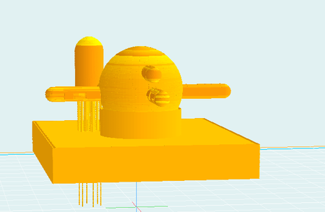

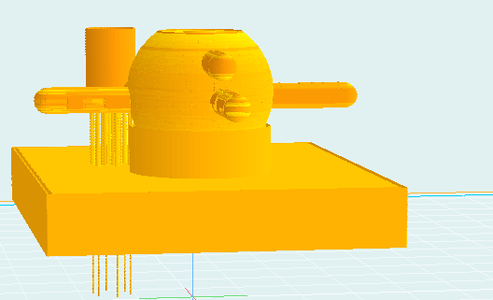

Step 6: Final Design

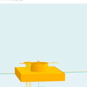

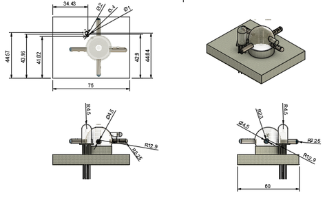

The final design involved putting all of the individual modules together and attaching together. The main modules are all located on the main (1st) floor deck, simply, because it allows the largest amount of modules to be attached to it by the size of its diameter. Although there are certainly other configurations this one seemed to be the best orientation. In addition, though main material of the design of the main hub is glass, this was intentional, since it would allow the viewer to examine the different floors and determine the orientation and layout of the habitat; however, the shell of the hub would most likely be made out of the steel alloy HY-100, due to the fact that having so much glass at such depths of 200m with a pressure of over 196 MPa would not be advisable from a structural design perspective. HY-100 is a steel alloy that was used in the design of multiple US Navy Nuclear submarines, and while possibly having some welding design issues, this did not seem to be a serious enough issue not to use it for this project, especially since producing enough titanium to build the entire habitat would be quite difficult given titanium's relative rarity. The main base of the habitat sits on a 10 meter thick slab of Portland concrete, in order to provide a secure foundation for the base, while the nuclear reactor module actually has its own base and stabilizers since its stability would be a top concern.
