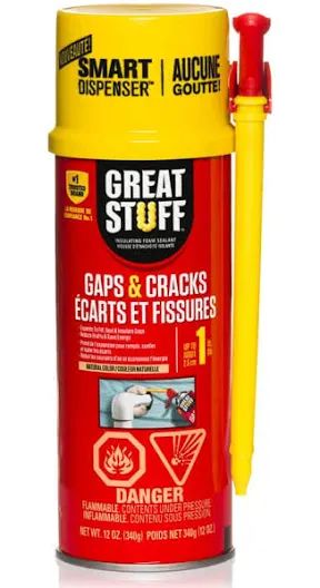

-Foam, foam and more foam (styrofoam)
-Hot Wire Cutters - various shapes and sizes
-Spray Foam
-Sander
-Paint - exterior and textured spray
-Exacto Knife
-Soft foam pipe cover/insulator
-Rope lights, puck lights
-Fog machines
-cellophane - red, orange, yellow, iridescent pearl
-twine
-hamster ball
-caps from spray foam
