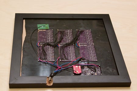

The system is based on the STM32F051 micro controller. I like to use it because it is very easy to program and use.
I used RN-XV WiFly as a Wi-Fi module. The module is a pleasure to work with: all you need is power, reset and UART lines.

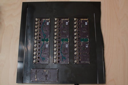

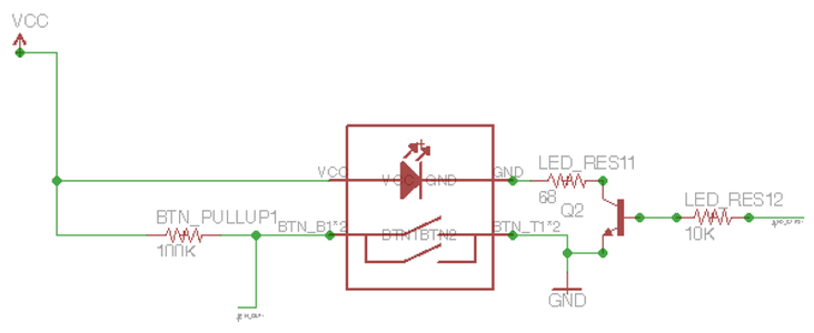

The board houses 35 momentary TL1265 buttons. Each button contains a LED and is hooked up via a transistor.

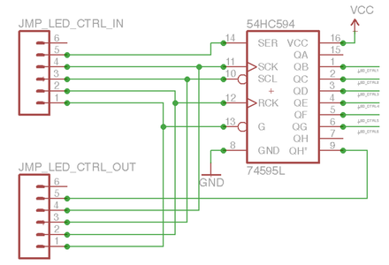

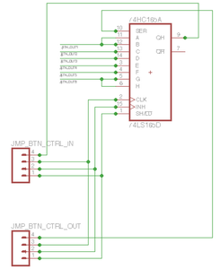

The buttons (and their LEDs) are connected via shift registers. I used 74HC165A to read button state and 74HC594 to control the LEDs.
I used OSH Park to manufacture the board. The quality of the board is quite high and it got done in 10 days.

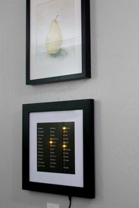

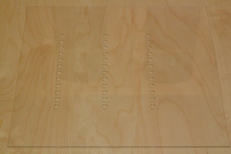

I really like amateur projects with good looking enclosures. I used a simple photo frame for this project. Inside the frame would has three layers: circuit board, cardboard with labels and a transparent cover board.

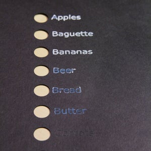

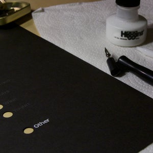

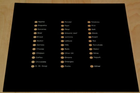

I think the trickiest of all was making a decent-looking labels. You see, I could either get a cardboard with perfect holes or reasonable labels. Eventually I used a laser cutter to make the holes, and then same laser cutter on a lower power setting to etch groves of letters. After that I used white ink and a calligraphy pen to fill the ink into the groves.
Step 5: Result
I am quite happy with the result: I am sure I my kitchen would be always well stocked.
