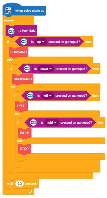

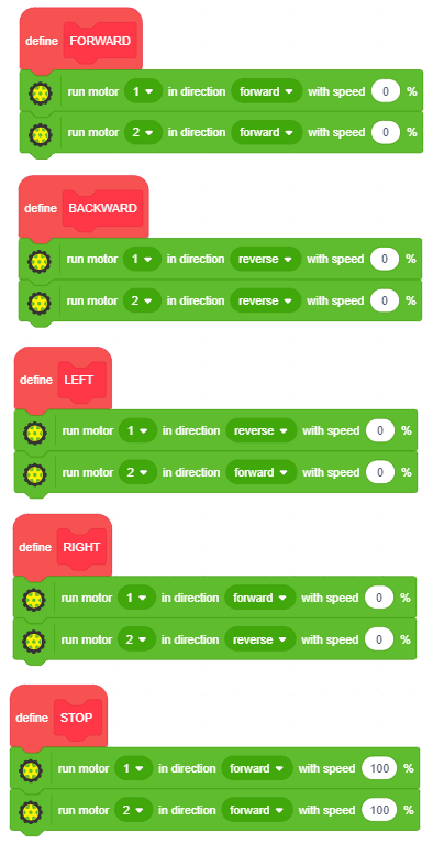

Step 9: Graphical Coding Section
We are going to script our entire program in a graphical programming software- PictoBlox. You can either write the following code or can upload the file given to evive.
The below code is the main code that will call the required blocks when the condition in the if arm is true.
The following shows the set of blocks from which anyone will be called from the main code. The robot will perform the actions according to the code written under the called block.

Step 11: Working of the Stair Climbing Robot
Stair climbing robot works on the concept of the rocker-bogie mechanism except we have stub axels to make the robot more stable. The robot can climb onto any obstacles stairs, bumps, etc. It can move along any surface be it sand, rocks, concrete, or grass as it has suspension arrangments. The front wheel of the robot hits the obstacle real hard and as the friction of the wheels is more, it lets the robot to climb the obstacle.
Dabble lets you connect your smartphone to evive. The buttons of Gamepad are used for the following function:
- Up: Move the robot forward
- Down: Move the robot backward
- Right: To turn the robot right
- Left: To turn the robot left
