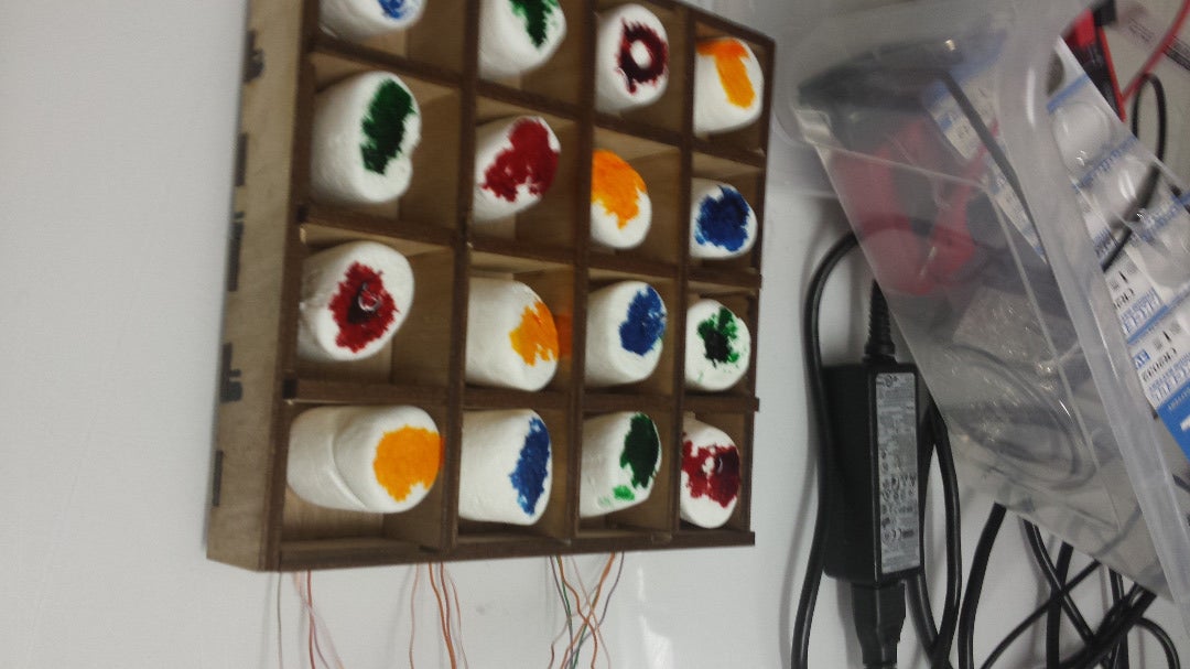

Step 4: Insert the Marshmallows
Insert the marshmallows into the wires in the box compartments. You want to be sure to get the bare part of the wire into the gooey centers.
For fun, we etched the leftover marshmallows and had some tasty treats for a snack. With our 60W laser, we etched at 100% power, 50% feed to get a nice contrast. Etching one entire surface caramelized the entire treat and made it a bit crunchy.
Hook your wires into the headers on the Makey Makey. If you want to use all 16 characters, you'll need to remap the keys with this method or by editing the settings.h file and rebuilding the embedded application on the board. If you won't want to remap the keys, you can connect two wires together and they can be the same key. You'll need to do this for four of the wires.
It doesn't really matter which headers you use for each wire because you're memorizing a pattern rather than specific letters or numbers. Nevertheless, you may wish to label the box so that you know which letters each marshmallow represents.
Open Notepad or some other text editor. Test each key. If you plan to label the compartments. this would be the time to do it. If any keys aren't working you may need to adjust the lead in the marshmallow or lick your finger to improve conductivity.
Step 5: Putting It All Together
Once it's all working, I put a drop of food dye onto each marshmallow to make it look nicer. Be creative. If you're really good, you'll be able to remember the colors for your password and be able to play them back like a Simon game. Sadly, you can't use this to login into a Windows computer. Windows won't enable the Makey Makey until after you've logged in. However, it works great logging into websites using your favorite browser or into other applications on your desktop.
