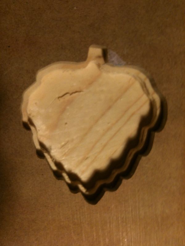

Here is where you have the option of simplifying the paddle or cutting out a fancy schmancy design. For the design option I made another Instructable on how to design and make a template for a plunge router in Photoshop because there are so many applications for that part. You don't really need Photoshop to make the template but is does make quick work of the design part.
**The simple option is to drill through several times and then smooth out the cuts. One approach is to drill evenly spaced holes laid out in grid. Another approach, which I tried out on my second paddle, is to use several different sized drill bits and scatter the locations to create a carbonation bubbles look. Whatever you decide, just remember to make it easy to clean grains out of it.
The final shaping of the paddle is all up to your preference. On the first paddle I made I used a round over bit to make smooth edges on everything. The second paddle I used a file to take a minimal amount off. I think I like the hard edges of the second one though. The hop design looses it's form when the round over is used. Although the 30 deg cuts look nice on the paddle.
