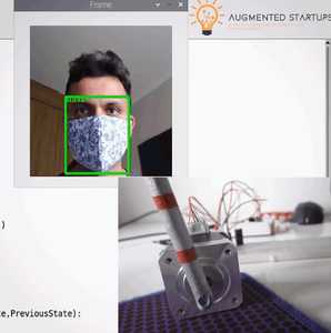

So the picture is captured the OpenCV AI Kit and model for mask detection at 30 FPS. This sends the image to the raspberry pi which we coded the logic for Access control. Stay till the end where I will explain how this logic works towards the coding section of this video, I will also show you a really easy way to annotate your dataset using the Roboflow platform. Anyways, the output of logic is then sent to the Stepper motor controller which triggers the signals to open or close the gate.

We start here and wait till the mask is detected. If a face is detected, we will check if the person is wearing a mask or not. If not then we will set the current state = 0, other wise if detected we set current state to 1. The next stage in our flow diagram, we compare if previous state = Current state. We are essentially looking for the transition or the edge trigger event. If we do not have a transition, we do nothing. But if we do detect this trigger, we will do a check as to whether Previous state = 0. You can perceive this better from the table. If both previous and current state = 0, it means that no mask was detected and the gate remains in the closed position.
If however, current state = 1 meaning mask detected, then that will trigger the gate to Open. The inverse is true for when previous state is 1 and current state is 0, the gate must close if the person takes off their mask. And then finally if previous and current state = 1, It means that a mask is being detected and thus the gate remains in the open position. Now you must be ask “Ritz, this is all nice and all, but cant we just say if mask detected then open gate, if not close the gate. “ haha, yes we can do that, but the problem with this is that we don’t want the gate to open again while its still open meaning that instead of being at the 90 degree mark the pole will extend to the 180 degree angle and viz versa. So this logic ensures that that motor does not over extend the pole in either direction. An easier alternative is that you can open the gate when mask is detected and close it after a set amount of seconds, and then open again when mask is detected. Let me know in the comments down below as to how you would apply this tutorial in your own projects.

Cool so when there is just background, nothing happens, when I place my face infront of the camera with out a mask the gate stays closed. When I put on my mask, the logic triggers and opens the gate which stays open as long as I have the mask on.
Perfect. It all worked as expected. Comment down below if you got this working on your Raspberry Pi as well as what you would like to see next on Augmented Startup. Now I want your notice, that there is bit of latency when the trigger event happens. This is because we are stopping our video temporarily to execute the stepper motor commands. The way you can mitigate this delay is by using threading. The completed code with threading you can find when you join YouTube membership or become a Patreon Supporter.
