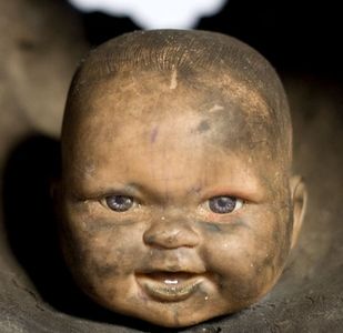

Step 1: Research Pictures.
The client sent me some of these pictures and I gathered others from Google Images for reference.
Also recommended to acquire a 3D reference like a toy doll head.

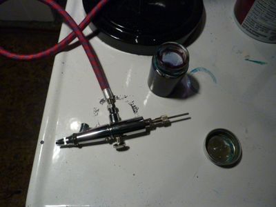

Step 12: Airbrushing.
Again, I can only give partial advice here. Airbrushing is a skill that I have yet to master. My particular airbrush is a very cheap one too, that clogs with ease and frustrates me to no end. But when I finally get it working and paint is applied to the crevices of the form, the piece really comes to life. A little shadow in the crevices and lighter tones on the surface can go a long way. It is totally up to you on how creative you want to be with this tool.
A word of advice that I can give, and is the same I hear from most painting instructors in general is to avoid using black paint. It muddies up your mix and can make you waste a batch of a colour you have been trying to achieve. Airbrush paint can be really expensive too, and usually comes in small quantities. A pantone reference could also aid you in getting your desired colour. It's always good to test out your mixed paint on a scrap piece of the fabric you are using as well.
