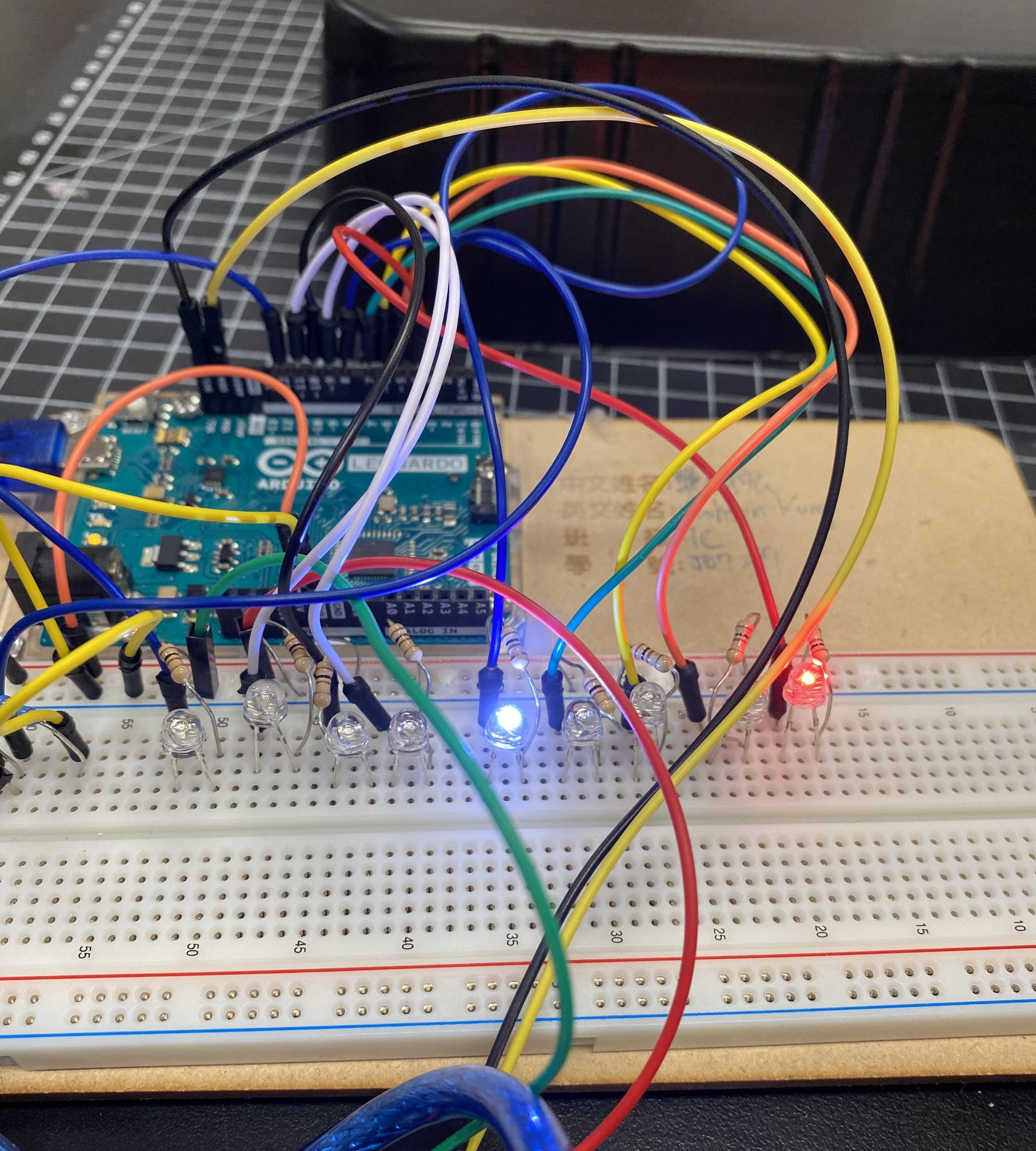

Step 1: Put on the LED Lights
You can adjust the color and the amounts of the lights in the way you like, just have a gap between each light.
Step 2: Put on the Resistor
Put the resistor on the same column as the right leg of the lights, and the other leg of the resistor goes to the negative. Do that for all the lights.
Step 3: Put on the Wires
  1. Take two wires. Put the first one into positive and 5V. Put the second one into negative and GND
  2. Take a wire, put it into the same column as the right leg of the LED light, and the other leg goes to D13
  3. Repeat this step for all the lights, but change D13 to D12, D11, D10, and so on.
Step 4: Put on the Ultrasonic Sensor
  1. Put the Ultrasonic sensor on the board
  2. Take 4 wires.
  3. For the first one, put it in VCC and positive
  4. For the second one, put it in Trig and D4
  5. For the third one, put it in Echo and D3
  6. For the last one, put it in GND and negative
For a better understanding, you can just memorize the first one is positive, the second one and the third one go to D3 and D4, and the last one is negative.
