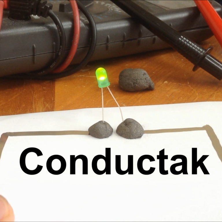

Add some flair to your masks with LED eyes and Conductak! Small 3mm LEDs leave decent visibility through eye holes, and since this technique is solder free you can add style to a wide variety of mask materials from paper to plastic and more! In this Instructable we'll go over two different methods of adding glowing LED eyes to a mask with Conductak.
