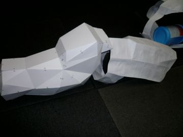

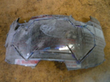

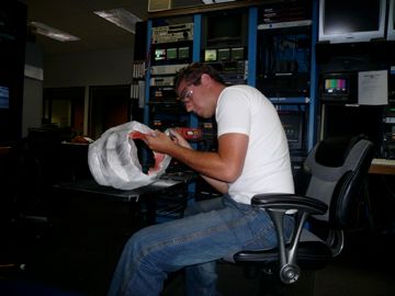

Step 2: Skeleton
I am going to call the first layer of the armor the skeleton since it will be the structure you will build off of.
Download the Pep files for the model of chief you want (available on 405th). Once you have them all set up and ready to print make sure sure you print on a good weight card stock. Personally I feel the heavier the better but if you have small hands and low grip strength just make sure it is thicker then pain paper.
Dear lord there are a a lot of shapes to cut out! I recommend doing one limb at a time so you don't get your parts mixed up.

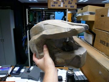

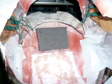

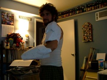

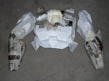

Step 3: Skeleton Part 2
Now the fun really starts! Take your paper skeleton and start goign over it with paper-mache. I justed a simple solution of laundry starch to stick it all together. It is cleaner and easier to work with at this stage.
Remember, use the starch sparingly because it is wet and you are building on paper. I recommend thin layers.
These strips of paper mache will slowly start to cover the seams of the folder and taped card-stock.
If you working in the daytime (unlike me) you can set a part such as a forearm out in the sun to dry while you start on the other arm. By the time you finish with the second arm your first will be ready for a second coat!
I learned from experience that you should add paper mache to the inside of the parts as well. This serves two purposes, first it strengthens the part and secondly it locks the joints of the card stock in place completely.

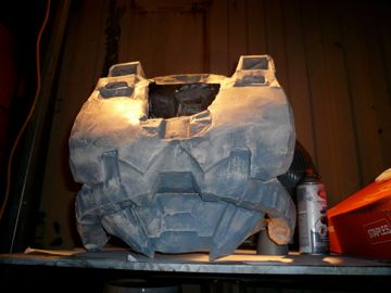

Step 4: Muscle
Now this is where may builders would stop. after all you can wear it, paint it, heck depending on your paper mache job it might look pretty good! However this is the delux armor so we are not stopping here!
IT'S BONDO TIME!
Now some people out here will be saying "Hey Mr 6, why not use resin and fiberglass? I say to them this, B
Bondo is not heavy when used correctly, hardens faster, and you can use it to add a more bulky, thick look to the armor.
So find yourself a well ventilated space or a gas mask and remember, SMALL BATCHES nothing is more frustrating then mixing a big batch and not getting to use it all because it hardened on your pallet!
A few tips on BONDO work.
Small Batches
The more hardener you add in (the pinker) the mix the faster it will harden.
Try not you get it on you.
Keep you tools clean.
Small Batches (really pressing the point.)
Wait till the first layer is completely hard before adding more in the same spot.
IT'S BONDO TIME!
Small Batches

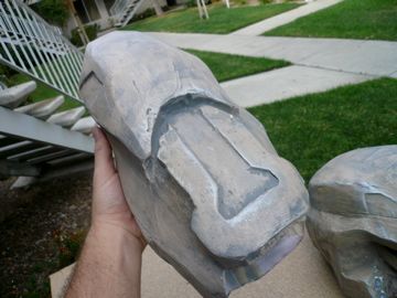

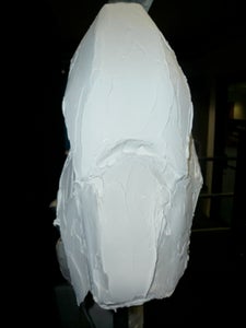

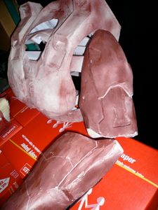

Step 5: Fatty Tissues
OK not that we have nice hard muscle over our paper bones we need to add some fatty tissue that will give us the final shapes we want.
For fatty tissues I used Join Compound. I prefer a low dust relatively dry mix, it was easier for me to work with.
Really cake it on but no more than a 1/4 inch in any layer or it will crack when it dries.
VERY IMPORTANT be patient and let it dry slowly, I tried using space heaters to cook the compound but it just cracked and made me have to add more layers (same problem with an oven).
You can however put your wet pieces in your car during the night. They will start drying overnight and when the sun comes up and start heating up your car, it will slowly raise the temperature and prevent cracking.

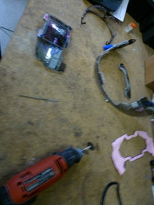

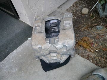

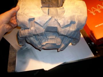

Step 6: Sanding and Shaping
Once your Fatty tissue is all the way dry you can sand down the fat to make nice smooth parts. Since joint compound is pretty soft it will sand easily and quickly.
Now is the time to take a pencil or pen and directly on the joint compound draw your details. If you use hi lighter, it bleeds though to the next layer you put over it so you will still be able to see your lines.
Once you are happy with the lines you have drawn on take yourself a rotary tool and trace out your lines. This gives the illusion of depth and layers of armor (fiberglass makes this much harder to achieve) .

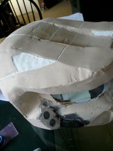

Step 7: Dermis
Remember how soft the joint compound was? Are you wondering how you are goign to keep it from falling apart while you wear it? Well this first layer of dermis (skin) is going to help big time!
Get yourself a nice thick lacquer. Sprays are easy but you need more layers. I liked the paint on stuff. It allowed me to get a nick thick layer onto the plaster so it could really soak in.
The Joint compound is porous and will absorb a lot of the lacquer making your fatty tissue much tougher.
After you apply as many coats as you see fit, blast the armor with primer.
If you suddenly see a spot where you missed a detail no worries, you can still carve into it, but remember to reseal the new details

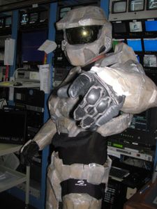

Step 8: Epidermis
Time for paint!
Start with a coat of paint that you think is a few shades too light, like this tan. I did two think coats of this.
Next get a very dark primer, such as dark gray or brown and spray it on the details and then wipe it off with a rag. This will leave the primer in the crevices and details giving the armor a weathered look.
Finally take some hammered silver (or brass if you want it to look like it was made of brass) and spray it on a bristled paint brush and use the brush to dab it on around the edges to look like the paint has come off and exposed metal.
For an excellent tutorial on the subject of weathering youtube HALO ARMOR PAINTING

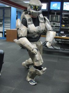

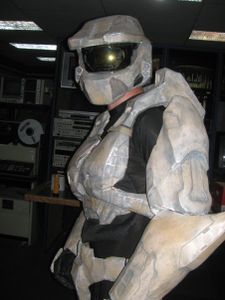

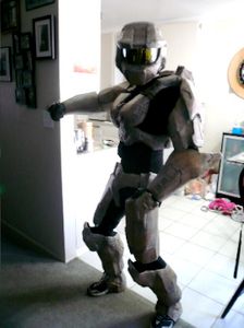

Step 9: Straps
Now that the armor is painted and dried put it on. feel where it is loose and add craft store foam to make it fit snugly. For the cod piece and but plate I found it easiest to install belt lops inside and run a belt thought it. I attaches straps from that belt to the thighs to keep them up as well. Be sure to use very strong glue when attaching all the straps. This is not the time to flake.

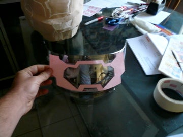

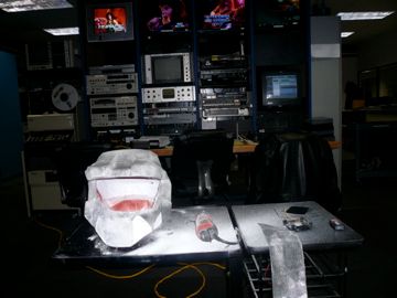

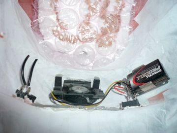

Step 10: The Helm
I went a bit nuts on my helm.
For the cool two tone lenses use two of the sam model motorcycle visor in the tints you think are coolest.
Trace you pattern directly on the protective film the lenses come in.
Take a deep breath and CAREFULLY cut out your pattern.
For me this was the most nerve racking part!
When they are freshly cut they will have rough edges so use a detail file to take the burrs off.
Once the lenses bits are smooth glue them in place and have a ball!

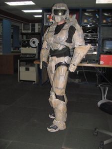

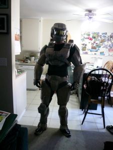

Step 11: More Pix
Well that's about it hope you enjoyed my first Instructable!
