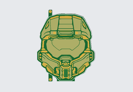

The PCB design for this project was split into two parts: the top layer board, or first board, which is just made up of solder mask opening layers, and a silkscreen that was themed after the helmet of the master chief.
The RGB LEDs and XIAO MCU are positioned on the second, or bottom, board. The RGB LEDs' glow is visible through the top PCB's solder mask opening.
We first looked for a black and white picture of Masterchief's helmet to use for the first layer, and we found one that will work perfectly.
We converted the image into BMP as we're using OrCad Cadence, which only imports logo files as BMP images.
After adding the basic image inside the CAD software, we added a top-etch layer by tracing out the helmet outlines. After that, we add a soldermask opening on top of the etch layer, which exposes the empty FR4 board along with the etch layer.
The etch layer, when exposed, will look silver or gold depending on the PCB surface finish, which in our case will be HASL or silver.
We added a soldermask opening on the bottom side as well, so light can easily transfer through the PCB.

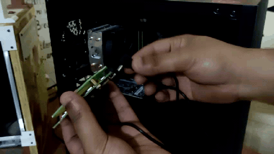

Step 7: Putting the Device Inside PC
For the last step, we have to mount this LED board inside the PC.
Two 3 mm-diameter mounting holes were added to the bottom PCB during the PCB design process. The PC's M3 standoffs, which are provided for installing ATX-sized motherboards, will be used to fasten the LED board with the PC.
We open the side pane of the PC first.
The USB cable is then connected to the XIAO and plugged into the motherboard's rear side USB port.
We then use an M3 bolt to secure the LED board on the ATX PCB standoff.

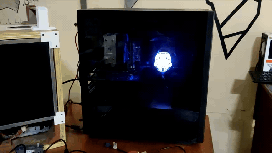

Step 8: RESULT
Here's the result of this small build, Master Chief glowing gloriously inside the PC.
Although I dislike RGB lights inside computers, this one seems quite lovely. I am going to build a couple more character LED boards and install them inside a desktop.
