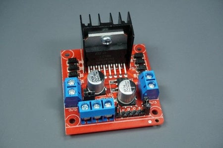

Step 1: Introducing the L298N Motor Driver
There are numerous methods to regulate a DC motor. The approach we’re adopting here is suitable for most hobbyist motors, requiring either 6V or 12V to function.
We’ll utilize the L298N motor driver, capable of handling up to 3A at 35V. Moreover, it facilitates the simultaneous operation of two DC motors, making it ideal for constructing robots. If you’re employing a different motor driver, fret not, as most modules function similarly with identical input and output pins.

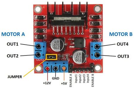

The pinout of the L298N motor driver is depicted below:
Step 2: L298N Motor Driver Pinout
Let’s delve into the pinout of the L298N motor driver and comprehend its operation.
For each motor, the motor driver possesses a two-terminal block on both sides: OUT1 and OUT2 on the left, and OUT3 and OUT4 on the right.
  • OUT1: DC motor A’s positive terminal
  • OUT2: DC motor A’s negative terminal
  • OUT3: DC motor B’s positive terminal
  • OUT4: DC motor B’s negative terminal
At the bottom, a three-terminal block is present with +12V, GND, and +5V. The +12V terminal block is utilized to power the motors, while the +5V terminal powers the L298N chip. However, if the jumper is connected, the chip draws power from the motor’s power supply, obviating the need to supply 5V through the +5V terminal.
Crucially, notwithstanding the name +12V, any voltage between 5V and 35V (preferably within 6V to 12V) can be supplied.
Note: If supplying above 12V, remove the jumper and provide 5V to the +5V terminal.

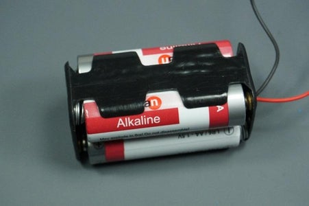

In this tutorial, we’re employing 4 AA 1.5V batteries yielding roughly 6V combined output, though any suitable power supply may be used. For instance, a bench power supply is suitable for testing this tutorial.
To recap:
  • +12V: Connect the motor’s power supply here.
  • GND: Power supply ground.
  • +5V: Supply 5V if the jumper is removed; otherwise, it acts as a 5V output.
  • Jumper: With the jumper in place, the chip is powered by the motor power supply. Remove the jumper if supplying more than 12V; provide 5V to the +5V terminal.
At the bottom right, four input pins and two enable terminals are present. The input pins regulate the direction of your DC motors, while the enable pins manage their speed.
  • IN1: Input 1 for Motor A
  • IN2: Input 2 for Motor A
  • IN3: Input 1 for Motor B
  • IN4: Input 2 for Motor B
  • EN1: Enable pin for Motor A
  • EN2: Enable pin for Motor B
By default, jumper caps are attached to the enable pins. Remove these caps to control your motors’ speed; otherwise, they’ll either halt or operate at maximum speed.

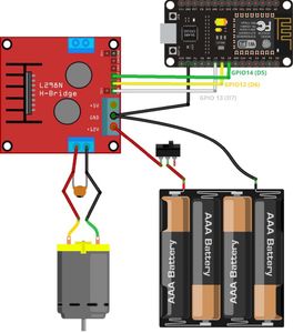

The motor under our control is linked to the motor A output pins, necessitating the connection of the ENABLEA, INPUT1, and INPUT2 pins of the motor driver to the ESP8266. Refer to the schematic diagram below to wire the DC motor and the L298N motor driver to the ESP8266 NodeMCU board.
Powering the L298N Motor Driver
Due to the substantial surge in current required to set the DC motor in motion, it’s imperative to power the motors via an external power source. For instance, we’re employing 4AA batteries, yet any other suitable power supply suffices. In this setup, a power supply ranging from 6V to 12V is viable.
On the schematic diagram, the inclusion of a switch between the battery holder and the motor driver is discretionary but practical for power control. This obviates the need for constant wire connections and disconnections to conserve power. Additionally, battery holders equipped with a button are available.

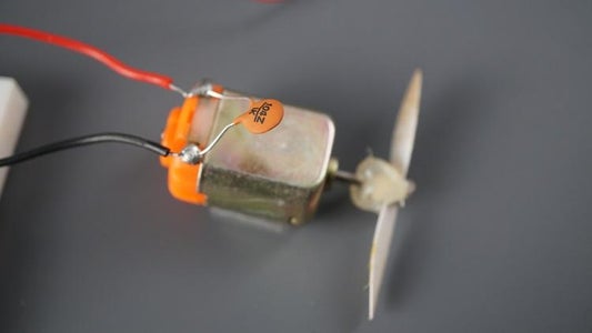

We advise soldering a 0.1uF ceramic capacitor to the positive and negative terminals of the DC motor, as delineated in the diagram, to aid in mitigating voltage spikes. (Note: the motors are operational even without the capacitor.)
