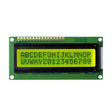

Step 2: Overview of 16x2 LCD
A 16x2 LCD is a common type of liquid crystal display (LCD) that can display up to 16 characters per line and has two lines. It is widely used in various electronic devices such as calculators, digital clocks, and small appliances. The LCD consists of a glass panel with a layer of liquid crystal material sandwiched between two polarizing filters. The LCD has a backlight that illuminates the display for easy viewing.
Step 3: Pin Configuration of 16x2 LCD
Before we can start displaying text on the 16x2 LCD, we need to understand its pin configuration. The 16x2 LCD has 16 pins, which are used for power, ground, data, and control signals. The following table shows the pin configuration of the 16x2 LCD:
Pin1 (Ground/Source Pin): This is a GND pin of display, used to connect the GND terminal of the microcontroller unit or power source.
Pin2 (VCC/Source Pin): This is the voltage supply pin of the display, used to connect the supply pin of the power source.
Pin3 (V0/VEE/Control Pin): This pin regulates the difference of the display, used to connect a changeable POT that can supply 0 to 5V.
Pin4 (Register Select/Control Pin): This pin toggles among command or data register, used to connect a microcontroller unit pin and obtains either 0 or 1(0 = data mode, and 1 = command mode).
Pin5 (Read/Write/Control Pin): This pin toggles the display among the read or writes operation, and it is connected to a microcontroller unit pin to get either 0 or 1 (0 = Write Operation, and 1 = Read Operation).
Pin 6 (Enable/Control Pin): This pin should be held high to execute Read/Write process, and it is connected to the microcontroller unit & constantly held high.
Pins 7-14 (Data Pins): These pins are used to send data to the display. These pins are connected in two-wire modes like 4-wire mode and 8-wire mode. In 4-wire mode, only four pins are connected to the microcontroller unit like 0 to 3, whereas in 8-wire mode, 8-pins are connected to microcontroller unit like 0 to 7.
Pin15 (+ve pin of the LED): This pin is connected to +5V
Pin 16 (-ve pin of the LED): This pin is connected to GND.

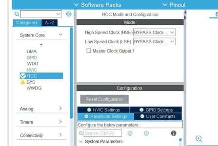

Step 5: Configuring STM32 Black Pill
To configure the STM32 Black Pill, we need to do the following steps :
  1. Select Pin from A0 to A5 as GPIO_OUTPUT pins.
  2. Now select the mode as RCC and in its connectivity setting select I2C1 option.
  3. Now, we will configure the clock.
  4. Then select the Button called Device Configuration Tool Code Generation in the top taskbar menu.
  5. It will give us the layout for code in which we write our own code.
Once the settings are configured, we can start writing code to display text on the 16x2 LCD.
