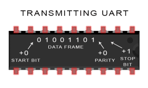

Step 2: How UART Operates
The transmitting UART, responsible for sending data, retrieves information from a data bus. This data bus serves as the conduit through which another device, such as a CPU, memory, or microcontroller, sends data to the UART. Initially in parallel form, data is transferred from the data bus to the transmitting UART. Upon receiving this parallel data, the transmitting UART augments it with a start bit, a parity bit, and a stop bit, effectively constructing a data packet. Subsequently, the data packet is serially output, bit by bit, from the Tx pin. On the receiving end, the receiving UART sequentially reads the data packet, bit by bit, at its Rx pin. It then converts the data back into parallel form while stripping away the start bit, parity bit, and stop bits. Finally, the receiving UART transfers the data packet in parallel back to the data bus on the receiving end.

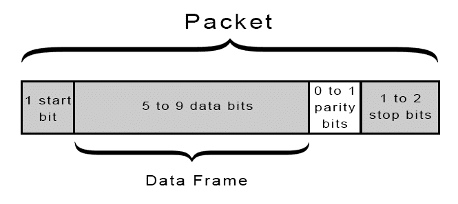

Data transmitted via UART is structured into packets. Each packet comprises one start bit, 5 to 9 data bits (depending on the UART), an optional parity bit, and one or two stop bits.
Start Bit
Ordinarily maintained at a high voltage level when not transmitting data, the UART data transmission line experiences a transition from high to low for one clock cycle to initiate data transfer. Upon detecting this voltage transition, the receiving UART commences reading the bits in the data frame at the baud rate frequency.
Data Frame
The data frame encapsulates the actual data being transmitted. It can range from 5 to 8 bits in length if a parity bit is employed, or 9 bits if no parity bit is utilized. Typically, data is transmitted with the least significant bit first.
Parity
Parity refers to the evenness or oddness of a number. The parity bit serves as a means for the receiving UART to discern if any data has undergone alteration during transmission, which can occur due to factors like electromagnetic interference, mismatched baud rates, or long-distance data transfers. Upon reading the data frame, the receiving UART tallies the number of bits with a value of 1 and verifies if the total is even or odd. In the case of even parity (parity bit is 0), the sum of 1 bits in the data frame should be even; for odd parity (parity bit is 1), it should be odd. A match between the parity bit and the data indicates error-free transmission. Conversely, if the parity bit is 0 and the total is odd, or if the parity bit is 1 and the total is even, the UART detects changes in the data frame.
Stop Bits
To denote the conclusion of the data packet, the sending UART transitions the data transmission line from a low voltage to a high voltage for a minimum of two bit durations.
Step 3: UART Transmission Process
The transmitting UART retrieves data in parallel from the data bus.
The transmitting UART supplements the data frame with the start bit, parity bit, and stop bit(s).
The complete packet is transmitted serially from the transmitting UART to the receiving UART. Meanwhile, the receiving UART samples the data line at the predetermined baud rate.
Upon reception, the receiving UART removes the start bit, parity bit, and stop bit from the data frame.
Subsequently, the receiving UART converts the serial data back into parallel format and transfers it to the data bus on the receiving end.
