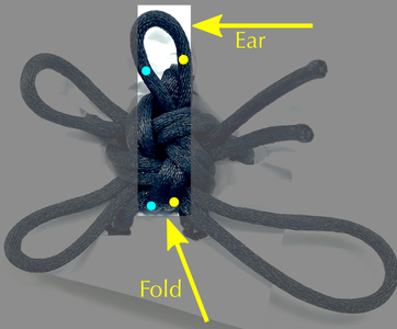

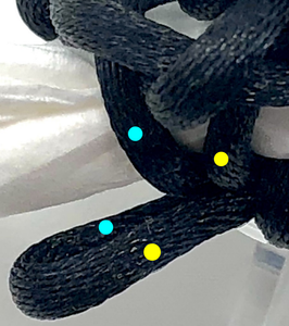

Step 4: Tightening the Knot
Tightening and truing up a mat faced good luck knot is tricky due to there being 3 layers:
  1. loose end/loop layer (good luck face)
  2. hidden layer which is the back of the good luck knot
  3. mat layer (mat face)
  • the folded end of an ear loop is easy to see from the GLK side.
  • the cord path through the mat side is also easy to see
  • when pulling slack from the folded side of an ear loop, it is important to remember that the cord will be traversing the hidden layer to just above the ear loop where the GLK joins to the mat
