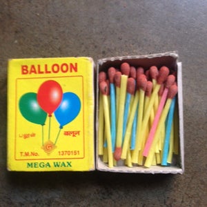

The first image above of the six boxes is what sparked my obsession. I was working for a company that makes cooking stoves, and in the office we always needed to have matches to light the stoves. These six boxes were all lying around the office one day. I particularly love the one named Puppy. That box is and will always be my favorite one. I think the design is just great, the puppy looks so regal and happy, and it is a PUPPY. Anyway, many of the others have stories too, but I won't bore you with them now.
Ok, just one more mini story. My good friend Santhosh went on a little vacation while we were living together, and when he came back I found those two boxes on the kitchen table. Each one had a bug inside. Clearly, Santhosh knows the kind of garbage that I like (the sign of a true friend).

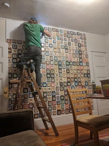

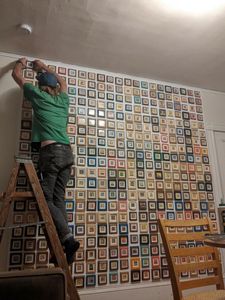

I quickly realized that hanging these frames with normal frame hardware would be far too tedious. Instead I decided to add a small magnet to the back of each one and hang them on a grid of screws in plywood. Here's the simple jig I made to align the frames for drilling. In the end, the single 1/8 inch diameter magnet was not strong enough to hold the frames. I ended up drilling three holes in each frame. One was for the magnet, and two more were for 1/8 inch dowels sticking out from the wall in a grid.
Step 12: Mounting
Thankfully I have access to a 4X8 foot CNC router at work. I used this to drill 1200 holes in two sheets of plywood. Sets of 3 holes are spaced in an even grid on the whole sheets. Each set of three holes has one for a steel screw that the magnet will attach to, and two for thin dowels to help hold up the frames. For installation I pressed 1/8 inch dowels in each hole and cut them flush with a simple jig and a Japanese flush cut saw so they would stick out a consistent distance from the wall. Flat head screws were counter-sunk to be flush with the wall. The install was again tedious, but in the end, I couldn't be happier.

I have dreamed of hanging all these little works of art in a gallery somewhere, but for now they are in my house. Lucky for me, I share a home with 5 other lovely people, so we had a small gallery opening just for us. Complete with wine, cheese and a strict dress code.
