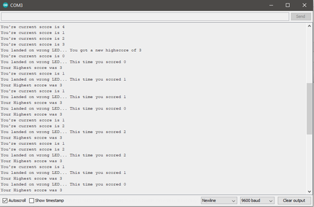

I created a circuit in which random colors are picked and where the user must attempt to match the colors as many times as possible for a high score as they blink on and off from left to right at a certain speed. The score and the info are displayed on the serial monitor. The buzzer also makes three unique sounds one for matching, mismatching, and a tune for a new high score. The project is quite simple and not too complex to understand. I've created a diagram on TinkerCAD as well as a working circuit in real life.

The circuit is made up of the 555 timer and the 4017 decade counter that is connected to the LEDs that work completely independent of the Arduino. The Arduino just checks to see what LED is on when the user presses the button and determines whether or not the user was able to successfully able to match the LED color to that of the RGB led. The 555 timer pulses at a constant pace and sends that electric current signal to the 4017 decade counter, whenever a clock pulse is received at the clock input of the 4017 decade counter, it increments the count and activates the corresponding output PIN, and turns on each LED one after the other in a loop.

Serial.print("You're current score is ");
Serial.println(points);

Serial.print("You landed on wrong LED... You got a new highscore of ");
Serial.println(Highscore);

Serial.print("You landed on wrong LED... This time you scored ");
Serial.print("Your Highest score was ");
