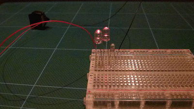

This gremlin/goblin hybrid uses a neat trick for blinking eyes. A flasher-LED that controls 2 regular LEDs. No fancy chip needed. But let's start from the beginning shall we...
LEDs will be wired in series for this one, so an optimal voltage would be around 9 volts. Since a tiny matchbox would not (or just barely) fit a regular 9V battery, I used 3 3V button cells, stacked. Soldering directly to these batteries are a pain, so the wires are secured with electrical tape.
2 red LEDs and one flasher-LED (blinks about once every second) are wired in series. The color of the flasher-LED is unimportant as it will be hidden anyway. You could use 1 or 2 red flasher-LEDs for this project, but the idea that one flasher can control any number or regular LEDs hooked in series is nice. Regular are cheaper, so if you are building something with a lot of LEDs, you could save some actual money by using this method.
When working with LEDs, or any electronics for that matter, it is always a good idea to connect components on a breadboard before soldering, to make sure everything is properly configured.
