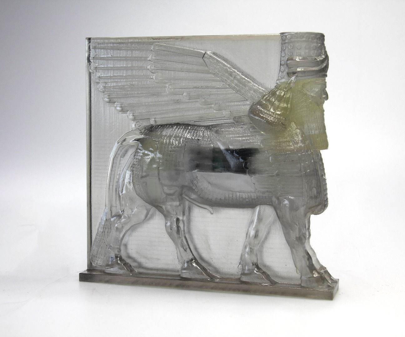

Step 3: Modeling + 3D Printing
At first, I thought it was possible to use software like Memento or 123D catch or Recap to create 3D models from images of the artifacts that were destroyed. I also found out that there is a project, called Project Mosul which is trying to use this process to re-construct these destroyed objects. But as I continued my research and met with different modelers and software developers/engineers, I soon realized that it will be almost impossible to re-construct most of these models from still images because there is just not enough high-quality images and documentations available from the artifacts. All of the software that use images to create 3D models only will work if one has access to 20-30 high quality images from different directions/perspectives and that's why I have doubts if the reconstruction idea from images will ever work for this specific case. This is when I moved to the 3D modeling from scratch idea.
As I mentioned, the hardest and most complicated aspect of my project has been the lack of information in general. I was amazed of how little information + images were out there (both online and offline) about these artifacts, the museum, and the sites that were destroyed. I did research in English, Persian, and Arabic for almost 2 months. Contacted so many people and resources and found very little amount of useful information. I think for me, this is the poetic and also sad notion of this project. How the destruction video went viral and was watched by so many people, but then so little resources and information is available about the artifacts and even the Mosul Museum itself ( which is the second largest museum in Iraq after the National Museum of Iraq in Baghdad)...And this is why it was extremely important for me to think about ways to gather this information and save them for both the current and future civilizations. Because so much of what ISIS or extreme Islamic groups want is "Re-creating" history; is demolishing and removing the past... and I love this idea of resisting that through the use of both digital and physical forms/materials. (In the coming month, I am also going to make the STL files available to public with a series of text and writing to be disturbed online).
So a whole team of colleagues, friends, and students helped me with modeling some of these artifacts (Shane O’Shea, Sierra Dorschutz, Patrick Delory, Christian Pramuk). <Some of these are still in progress>. Then I took them through different 3D modeling/printing software, cleaning the meshes, creating memory card and flash memory "cuts/holes" inside the "body" of each piece and 3D printing them in clear material. So the idea is that you can see these digital artifacts inside the physical bodies of these 3D printed ancient objects.
