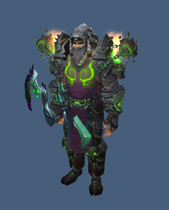

Now that you have download WMV, just open it. If it doesn't open on its own just after the installion ended, just open find the location of the file called WowModelViewer. It is normally located in the program file.
Every time that you will open WMV a warning message will pop up and will ask you if you want to load Wow, just answer yes. As you can see there is a big menu at the left of your window. This menu is dedicated to the creation of your character. There you can choose any character existing in wow including animations, landscpaes, ...
But, if you already have created a character in Wow, you can load it easily. You just have to click on the character tab located above your window. Once it's done, just click on "Import Armory Character". Then they will ask you to provide a link of the character you wish to import. Unfortunately you must provide a link from this website : http://battle.net/, such as : http://eu.battle.net/wow/fr/character/archimonde/S... Then just wait a little and you will see your character.
Step 3: Prepare Your Wow Character to Be Printed
Now that you have your character, just export it. Unfortunately, you can only export it as a OBJ file but it doesn't really matter. To export it, just click on "File" at the upper left side, then click on "Export Model" and choose OBJ.

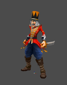

No, just move the file downloaded in the addons file of Blender. Once it's done, you can now import SKL and SKN file. So, to have champions SKL and SKN file you will ahev to download the champions and skin wished on this website : http://leaguecraft.com/skins/ The SKN file is the file of the character and the SKL file is the file of the rig of this same champions. Consequently, you can animate it or make it change position if you can.
I will join a picture of Volibear which I import in Blender. I advice you to removre Remove Doubles, just after imorting your champions.

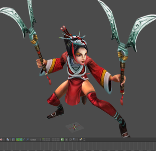

I will join a picture of Akali that I printed but I had a problemn with my printer and had some difficulties to remove the support, but anyway this doesn't really matter. I hope you will enjoy materializing your Wow/Lol character.
