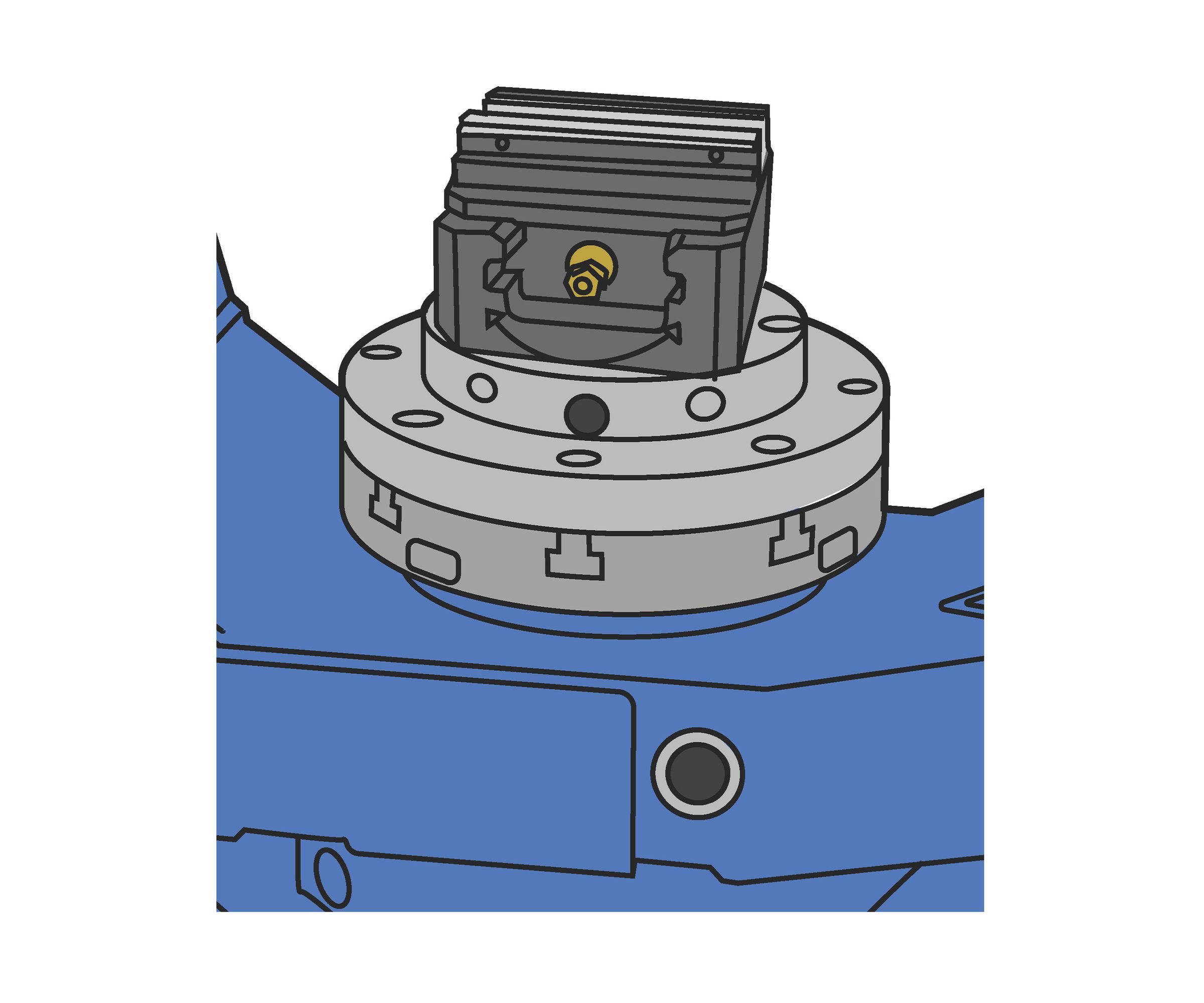

Install vise in machine.
- Press Door Unlock.
- Carefully wipe chips from receiver plate and bottom of vise.
- Set vise on receiver plate.
- Tighten front bolt to 30 Newton-meters using a torque wrench.

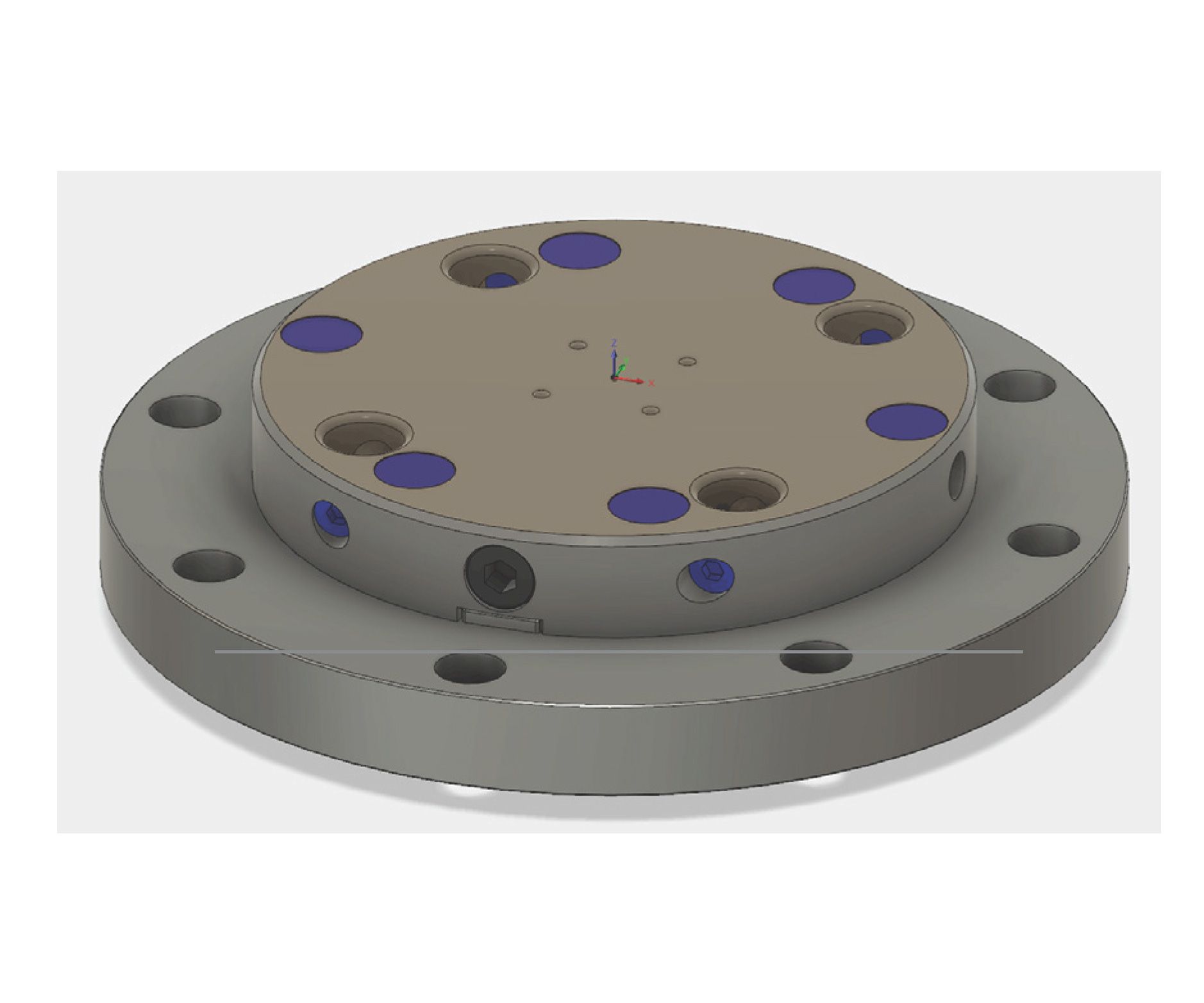

Because Work Home is set to the top center of the Lang receiver plate, you don’t need to probe your stock. As long as the receiver plate is not moved for a custom project, G54 will not change.
