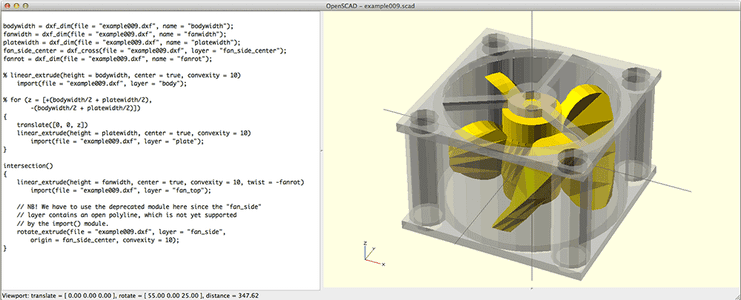

Step 3: Install OpenSCAD
DISCLAIMER: For this tutorial, we are going to use *only* opensource software!
You need also to install OpenSCAD:
http://www.openscad.org/
They say:
"OpenSCAD is a software for creating solid 3D CAD objects. [cut] OpenSCAD is not an interactive modeller. Instead it is something like a 3D-compiler that reads in a script file that describes the object and renders the 3D model from this script file. This gives you (the designer) full control over the modelling process and enables you to easily change any step in the modelling process or make designs that are defined by configurable parameters."
Download it and install. Link and installation guide for your os are on the download page:
http://www.openscad.org/downloads.html
They say:

Step 8: Import Formula / Expression in OpenSCAD
Open OpenSCAD and simply go to:
File -> open
and choose the file created on the previuos step!
You can see on the left side a lot of codes: it's not important to read (and understand) :D
In the right side there's still nothing.
To compile all the code, you need to press F5 key.
And after a while, here you are your formula in 3d !
From now, you can export your new OpenSCAD project simply:
- compiling and rendering the code pressing F6
- exporting it in STL format (the format used normally in 3d slicing & printing software); go to:
Design -> Export as STL..
